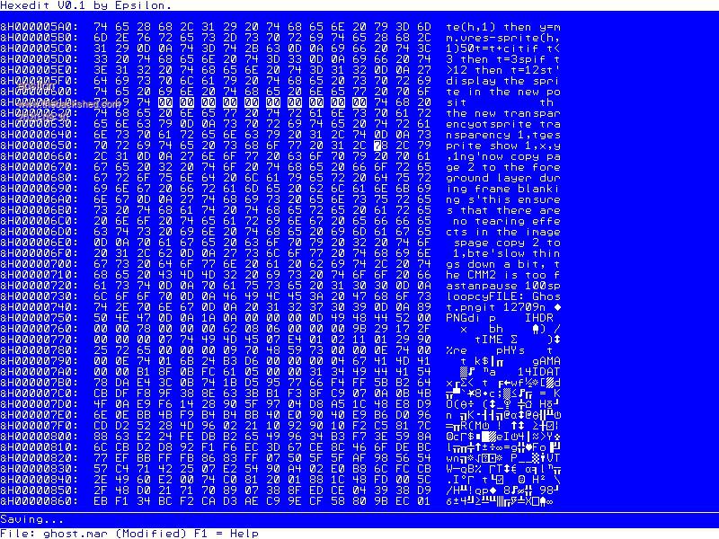

Hi all,
I made a hex editor for binary files. See description of the tool below. I hope that some of you will find it useful.
I might derive a memory editor (a peek/poke front-end) from this once the dust has settled.
Feedback is welcome of course, in particular if you find that some key bindings aren't working correctly. I have a Belgian keyboard, which is not supported. I have it currently configured as a french keyboard, which is not a perfect match, some I'm not 100% sure I got all key combos correctly. Let me know please.
Any other feedback is welcome too of course, including coding practices.
GitHub: https://github.com/epsilon537/hexedit_cmm
hexedit.zip
Cheers,
Epsilon.
Description
HexEdit allows you to edit binary files, i.e. files that you can't edit with a regular text editor such as the built-in editor.
The file's contents are shown as hexadecimal byte values and as ASCII code in two side-by-side blocks. Changes can be made both in the hex table section and in the ASCII section.
The usual file navigation with cursors keys, page up&down, home, end, etc. should work as expected.
Hexedit is a full-screen console-only editor. I does not work over serial, sorry.
Press F1 to get help on key bindings.
Current limitations
File Size Limit: 1MB
Byte mode only. No support (yet?) for 16-bit and 32-bit modes.
