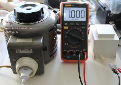

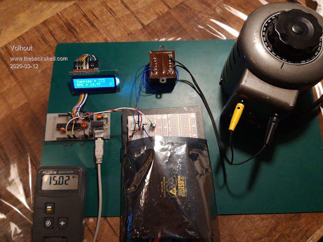

I was a bit optimistic on the sample rate achievable, but I have an example for you anyway. I hope this is of any use.
The circuit and algorithm are for measuring AC voltages. In my test I have used a variable transformer driving an small 230V->18V transformer (for isolation, don't want to electrocute myself).
The RMS (abbreviation for R(oot), M(ean), S(quare)) is calculated from an array of 800 samples, between 2 zero crossings. The measurement values are accurate (checked against a Fluke multimeter) within 1 percent between 0V and 20V.

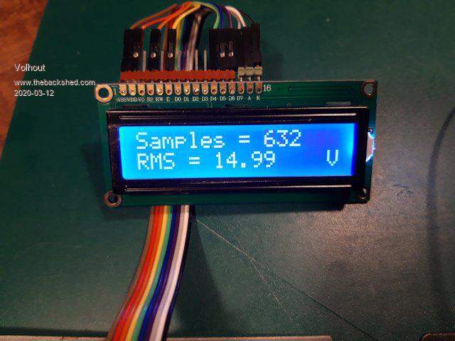

In this example I display the RMS value at a 16x2 LCD.
It also shows how many samples are used to calculate the RMS value.

The test setup
The LCD displaying samples and RMS value

The current component values (R4=120k, R5/R6=10k) attenuate the input signal (120+5)/5 = 25 times. So the maximum measurement range is +/- 25x1.65 = +/- 41V. If a sine wave is applied that is maximum 41/1.4 = 30Vac
If you need more range, you will have to increase resistor R4.
Capacitor C1 can be a low voltage part. Typically it has only 1.65V across it.
Protection diodes are not in this circuit since the R4(120k) limits the current sufficiently to rely on the internal protection diodes inside the MX170. If you are in a very dirty electrical environment (welding equipment, large pumps, Tesla coils...) you may want to add them though.
The duinomite is an MX470 (same as maximite), so it should run faster than the MX170. Remove the CPU 48 command from the program, it will throw you an error.
Edited 2020-03-12 21:07 by Volhout
