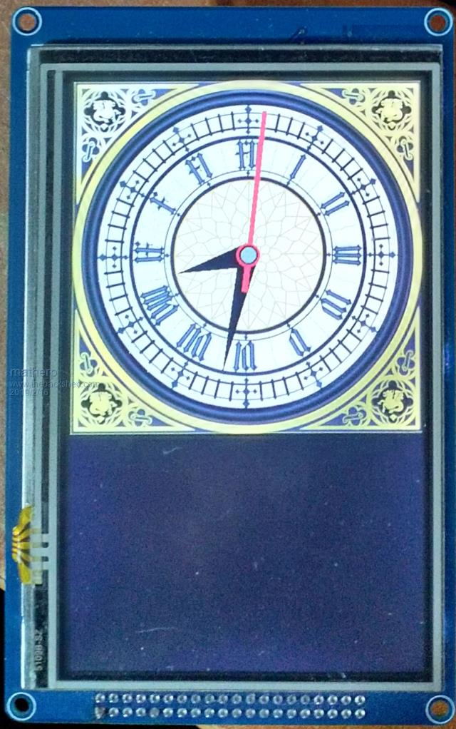

I had a hard drive failure, and as a result I lost all my programming I did with the Big Ben clock
I've been trying to make it again with a Picromite to make a simple analogue clock using the SSD1963_7 in Portrait mode.
but for the life of me I cannot get it going
I've been trying to use Peter's sample code here using BLIT
but my mind has completely gone stupidly blank
no matter what I do I cannot even get the hands drawn, let alone move.
I did manage to get the background picture off another post, so that's a bonus
Moral of the story - always have backups on more than one drive.
I think it's time I admitted to myself my memory problems are making it impossible to do this any more.

I've found a copy of the Big Ben clock that works on an E100 but it won't work with the Picromite because it uses CFunctions to do the triangles for the clock
I know I'm asking for a lot but is anyone able to "convert" it so it will work on the Picromite using the BLIT command instead of the CFunctions?
I cannot get my head round how I got it working in the first place and it would take me weeks to learn how to do it again
I've cut the code so it's only the clock bit and not the complete weather station as this is all I want - to make a large clock using the SSD1963 7 inch in Portrait mode and at a later stage I'll add day and date underneath the clock
2019-02-16_050350_bigben.zip

Here you go
option explicit
option default none
dim integer buff(480*480*3/8-1)
dim integer nt=4 'Number of triangles being updated
dim integer xx0(nt-1),yy0(nt-1),xx1(nt-1),yy1(nt-1),xx2(nt-1),yy2(nt-1),tcol(nt-1),secs,mins,hours,first=1
cls
load image "bigben.bmp",0,0
blit read #1,0,0,480,480
option autorefresh off
Circle MM.Hres\2, MM.HRES\2, (MM.HRES\2-MM.HRES\12)\12, 0, , rgb(red), rgb(red))
Circle MM.Hres\2, MM.HRES\2, (MM.HRES\2-MM.HRES\12)\15, 0, , 0, 0
Circle MM.Hres\2, MM.HRES\2, (MM.HRES\2-MM.HRES\12)\20, 0, , RGB(gray), RGB(gray)
secs=val(right$(time$,2))
mins=val(mid$(time$,4,2))
hours=val(left$(time$,2))
do
hands(secs,mins,hours,(MM.HRES\2-MM.HRES\12),MM.Hres\2, MM.HRES\2)
secs = (secs + 1) mod 60
if secs=0 then mins = (mins+1) mod 60
if hours=0 then hours = (hours+1) mod 12
pause 1000
loop
end
Sub hands(seconds As integer, minutes as integer, hours as integer, size as integer, x as integer, y as integer)
Local integer x1,y1,x2,y2,x0,y0,i
local float angle=seconds*6
rotatetriangle(2,RGB(RED),angle,x,y,-3,50,3,50,-3,-size) 'make up the second hand with two triangles
rotatetriangle(3,RGB(RED),angle,x,y,3,-size,3,50,-3,-size)
angle=minutes*6 + seconds/10
rotatetriangle(0,RGB(BLACK),angle,x,y,-size/15,0,size/15,0,0,-size*0.8)
angle=hours*30 + minutes/2
rotatetriangle(1,RGB(BLACK),angle,x,y,-size/12,0,size/12,0,0,-size*0.5)
blit write #1,0,0
triangle xx0(), yy0(), xx1(), yy1(), xx2(), yy2()) ,tcol() ,tcol()
Circle x,y, size\12, 0, , rgb(red), rgb(red))
Circle x,y, size\15, 0, , 0, 0
Circle x,y, size\20, 0, , RGB(gray), RGB(gray)
refresh
sub rotatetriangle(n as integer, col as integer, angle as float, x as integer, y as integer, x0 as integer, y0 as integer, x1 as integer, y1 as integer, x2 as integer, y2 as integer)
local float sine=sin(rad(angle)),cosine=cos(rad(angle))
local integer x0a,y0a,x1a,y1a,x2a,y2a
x0a= x0*cosine - y0 * sine + x
y0a= y0*cosine + x0 * sine + y
x1a= x1*cosine - y1 * sine + x
y1a= y1*cosine + x1 * sine + y
x2a= x2*cosine - y2 * sine + x
y2a= y2*cosine + x2 * sine + y
xx0(n)=x0a
yy0(n)=y0a
xx1(n)=x1a
yy1(n)=y1a
xx2(n)=x2a
yy2(n)=y2a
tcol(n)=col
end sub
lew247
Joined: 23/12/2015
Posts: 1709
Posted: 08:43pm 15 Feb 2019
Peter you really are a star
Thank you so much

lew247
Joined: 23/12/2015
Posts: 1709
Posted: 09:43am 16 Feb 2019
Peter if you see this have you any idea why the second hand always skips the 12 position?
It was skipping a second a couple of random times a minute and I figured it was down to the pause 1000 so I got rid of that and now it's really smooth other than when it reaches 12
it always skips 12
any ideas why?
I also changed the picture, it looks much better in White
2019-02-16_194213_picture.zip

Posts: 12084
Posted: 09:54am 16 Feb 2019
  Quote   if secs > oldsecs then
0 is less than 59
try
secs <> oldsecs
lew247
Joined: 23/12/2015
Posts: 1709
Posted: 10:07am 16 Feb 2019
Thanks Peter, that worked

clockBMP.zip
TrevorH
The newest MM code doesn't require Cfunctions for the triangles
here's code for just a clock with a simple weather readout as well using Matherps code for the hands
Clock image in the zip file
'***Thanks to Matherp for his help with the hands***
