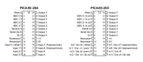

What is the difference between the 28 and the 28X1?

Dom,
There are 4 versions of the 28PicAxe. The 28A, the 28X, the 28X1 and the 28X2. The 28X2 is not yet available but will be released eventually. I can't recall all the differences but the charger is made to utilise the features of the 28X. The 28A will not do because it does not have PWM which is what this modified charger is all about. You may find the more advanced featured 28X1 will still do the job, but why pay more for features not used?

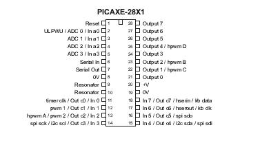

Posted: 07:27am 16 Dec 2008
Hi Dom,
Most of the info you need is in the picaxe programming application in the help section.
These are the pin connections for the 28A,28X,28X1.
Gordon.
PS. I see PWM is available on all the X-series, but not the A-series. I will be waiting for the 28X2.

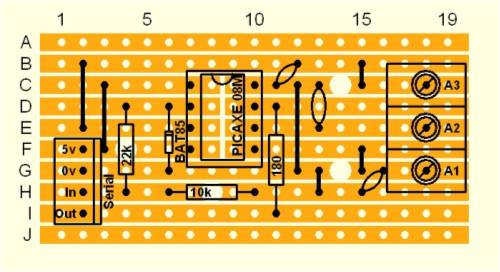

Posted: 10:02am 16 Dec 2008
what software do you use to design the veroboard pcb's looks like it makes a nice job

greigy,
I use StripBoard Designer 1.01
It's free but it does have some quirks but I know my way around them now. Should you get it, I can give you my component library which is much more than the basic ones supplied.
The free download may state it will take 1,000,000 minutes before saving your work, accept that, then 'OPEN' the same file. A window appears that overrides the nag setting, file saved.
There are other free strip board (veroboard) designers out there. Some are too basic and restrictive but do a google and see what you come up with.

Gordon and Gill,
Thanks for answers. Notice the pins have additional functionality from a 28X to a 28X1.

  Gill said   greigy,
Hi Gill,
You still use Stripboard Designer? I found a better one here. Is free and no limitations and is looking great. It have also a version for Win98 if someone is still using it for electronics and CNC ...
It have three modes:
- stripboard
- perfboard
- pcbEdited by vasi 2009-03-05
