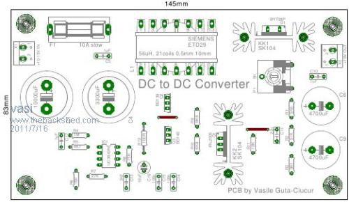

I had the original .pdf file with schematic and component list from the internet, don't remember from where exactly. I still have it but I have to see on which DVD...
I printed it on paper some time ago with the intent to start building it...
Is a DC to DC converter for a laptop connected to a 12volt battery. My solar battery is 12V and this converter is what I need because I have many devices on 12V.
I did the pcb design, hope is useful for others. I can't offer guaranties, don't know if is working but I started building it anyway...

Errata:
The diode D1 is MBR1645. I had to find a footprint with TO220 case and forgot to change the value. Sorry!
The diameter of the L1 is 10mmm, on ferrite. But you can buy a transformer case for it, ETD29 model, vertical position (I have horizontal). It have a special ferrite for it (it come in two pieces - I bought one piece/half by mistake). I will put pictures for reference.
You need one of this. Mine is horizontal - good enough but ugly:
And two of these.
Resistors:
R1 = 5k6
R2 = 51k
R3 = 9k1 (9.09K)
R4 = 1M
R5 = 4k7
R6-R8 = 15k
R7 = 27k
R9-R10 = 6k8
R11 = 10K
R12 = 100 ohms
Capacitors:
I think notations on schematic are clear
All non polarized capacitors are "caramel" type, 5mm distance between pins:
Others:
Two cooling radiators SK104 STC or STS for TO220, 38.1 mm:
SK104STC 11K/W 38,1mm Fischer TO220 RoHS
VasiEdited by vasi 2011-07-17

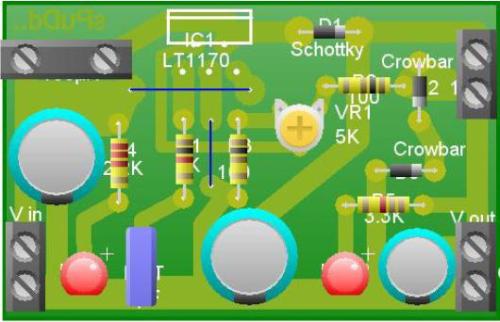

I built a DC-DC for same reason. I used a monolithic IC - much simpler design.
See below for files.
My DC-DC Project
LT1070 Series PDF
LT1170 Series PDF
LT1170 Series Design Notes PDF
LT1070 Series Inductor Selection PDF
It should work ...in theory

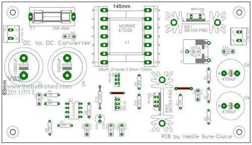

I found the footprint for a horizontal ETD29 transformer so I did the PCB for this.
2011-07-17_022414_DCtoDC_H.zip

  sPuDd said   Yasi,
My DC-DC Project
LT1070 Series PDF
LT1170 Series PDF
Thank you sPuDd, yours ia indeed much simpler and is tested so I'll recommend it.

What program you used to render such image?
I ask because I like it, I see it appropriate in illustrating documentations and tutorials.

Vasi,
I used PCB Wizard 3.50 Pro Unlimited, be warned it has some
incorrect parts errors, and other bugs/issues. Yes it was a nice
pretty program, but at a price...
There's a good chance you can get free samples of the LT1170
from Linear Technology. There is also the LT1268 which is a
150Khz 7.5A version of the same thing.
