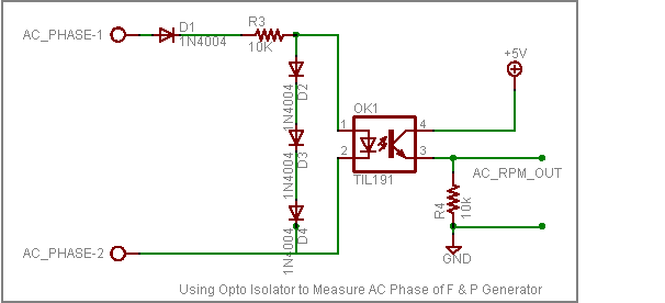

Here is an example of using on optoisolator to measure the pulse in a safe way that can be fed directly to a microcontroller etc. Almost any opto you have can be substituted.
Gill thanks for the explanation, i can now understand why my readings were out and different with the new rotor. Getting more reasonable rpm readings now and is great

hi rifraf its looks an easy circuit to put together but what are we suposed to do with the ac rpm output?

hi matt, i send the pulse to an avr for logging the RPM on a PC with the piclog application, you could hook the output upto a frequency meter. I also have the RPM displayed on an LCD screen now with windspeed at the betteries, very handy for testing blade performance with different rotors and stator windings.
the opto isolator schem was just chopped from a schematic based on the same design as the piclogger and so may appear incomplete for this reason
