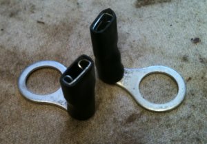

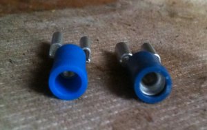

I made some battery post fuse holders today. I have 4 lead acid batteries connected in parallel, nothing special, powers some garden lights. I do have a big 50 amp maxi-fuse to protect the whole bank, but I really wanted to fuse the batteries individually. As I only draw a few amps, 4 amps max, I decided to use cheap automotive blade fuses. But how to mount them?

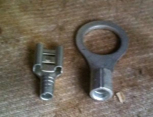

First up, some spade connectors. I used the type shown on the left, with the basic crimp, its easier to slide off the plastic insulator and they will fit neatly into the big eyelet connectors.

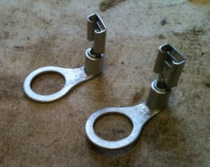

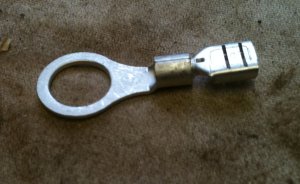

I bent the eyelet crimp at right angles and fitted the spade connector, perfect fit.
Then soldered them together and fitted some heat shrink.

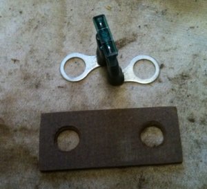

Fused fitted. Marked out a piece of masonite ( 3mm ply wood would work just as well ) and drilled to suit the eyelet spacing.

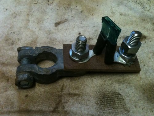

The finished fuse holder mounted on a battery terminal. Cheap and does the job.

That is very clever. It would never have crossed my mind to come up with a fuse holder like that, I would have just bought one. I will keep that idea tucked away in my mind.

Good idea, thats innovation, on the same theme I have made fuse holders like that using double sided fiber glass pc board by drilling a hole to take the spade terminal and soldering to both sides, with a cut in the copper both sides of course. Doing it this way it is possible to string a series of fuses on the one piece of board to the one active terminal. I have tested it to 30 amps and the board will take it OK. It is a good idea to tin the board for corrosion and to carry a bit more amps, then a coat of clear estapol or similar, A led and series resistor across each fuse ads a blown fuse indicator without having to pull them out to test.
