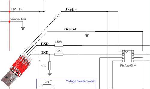

Can I hook this USB Module this way to the picaxe and take out the regulator?

Hi Windman
Do you have any info on that USB module? Is it a USB to serial adapter or something like that.

Hi Windman
Nice little USB Serial thingy.
Yeah I think that should be OK. The USB +5v will drive the PicAxe chip fine, so you can take out the 5v regulator. I would add a couple of 0.1uF caps across the +5 and 0 volt points, just to filter out any noise.
The only thing to watch is the sensors. If your wind sensor is using the +5v supply, and its on a long length of wire, then this may cause some problems. Trial and error will tell you. If the PicLog gives weird results, and disconnecting the wind sensor clears it up, then you might need to look at fitting more caps across the supply at different points, or fitting the 7805 back into circuit.
Let us know how you go.

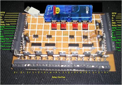

This is what im building, 1 pcb board with 4 loggers Using 14M picaxe Chips To replace my 5 boards using 8M piaxes ( 1 board is For Dump load And 4 other boards are for logging my Mill and solar to this site and my site).
With the new board im building il have 20 relay outputs way over what i need and 4 extra inputs for further add on.
My RPM and Wind Speed sensors are 10-30 vdc inputs and pulses the signal , they will still be ran from the battery bank.
Here A picture of what im doing but this picture I have crop on the USB hub ans USB serial adapters .

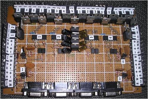

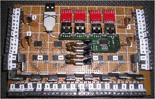

Well after 3 weeks I finaly receive my USB modules and install them,And the computer install the USB HUB and the 4 new COM PORTS, I could not get any COM DATA, I Switch TXD and RXD to see if I had them backwards, I disconnected the USB HUB and ran off one module and still could not get COM DATA,
I disconnected the 5v from USB and installed the volage regulators , still no COM DATA.
So I gave up and Took the USB modules off and install the DB9 Serial Plugs.
Everything works good but needed to change the 10K Resistor to a 6.8k in the voltage messuremet ,now the voltage is linier from 10v to 31v.
