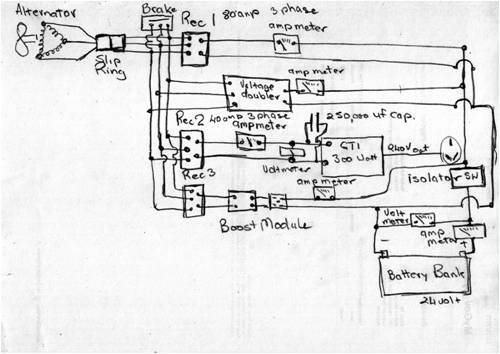

This is a mud map of my experimental setup on my mill, also have a 300 watt and a 600 watt GTI on the dump load on the battery pack using Glenn's dump load circuit. I have mine set to cut in at 27 volts and drop out at 25 volts, they will go to 30 volts but cut out on over voltage. Mine will draw 12 amps at 27 volts and a bit higher until it heats up. It just starts to conduct at 15 volts around 2.5 amps from memory. I have tried it on the solar but the volts go to high and it cuts out (24 volt system) voltage 40 on a good day need MPPT to the batteries, I got a 22 to 55 volt 600 watt unit but haven't tried it yet as we have had to much overcast weather.
All the best
Bob

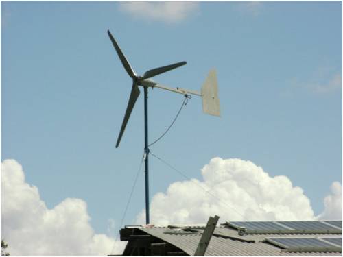

Sounds a bit complicated for an old bugger like me, I have a old Chinese mill with no slip rings and use a bungee cord toed to the tail, it can rotate 2 turns then the bungee cord winds up and brings it back to normal.
Note the bungee tied with precision and finesse onto the carefully fabricated tail extension.
I use high quality bungee from a sail maker as it is purported to be UV proof, a bit crude but it works like a treat.
