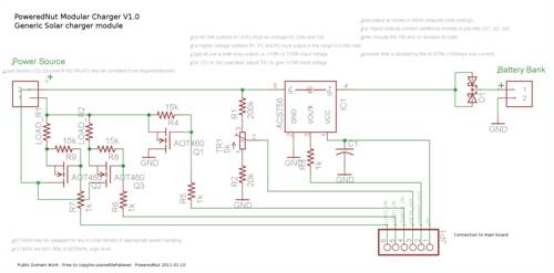

Okay, slow progress, but here is the first attempt at a Solar charger module. I've not used Mosfets in this particular configuration before (copied it from Gizmo's circuit) and it is untested at this point as I'm waiting till I have everything designed before I put in a parts order. Build at your own risk. PCB layout to follow once I know it works.
It should (I hope) work fine for 12V or 24V systems with no changes. Higher voltage systems will require a few changes. The voltage divider (R1, R2 and TR1) should output a voltage somewhere in the range 0-4.096V. For the 12V and 24V systems, as drawn, it should output 1/10th the input voltage(i.e 1.2V for 12V). The resistors i've specified for 48V systems should output 1/20th (i.e 2.4V for 48V) when adjusted with TR1.
Parts are available from digikey.
Comments and suggestions welcome.

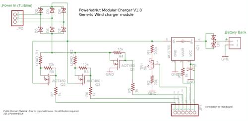

Here is the generic wind turbine charger module. Pretty much identical to the solar, with a minor redraw for clarity and the addition of the rectifier.
same details as before - it has not been experimented with, built or tested. use at own risk.
Comments and suggestions welcome, as before.
Posted: 09:37am 10 Jan 2011
Hi,
Can you put the schematics in a pdf file and upload the file as i can not read them and the blur to much when i enlarge them.
curious..........why the diodes across the battery, they just create further losses.
Pete.

Posted: 02:46pm 10 Jan 2011
  Downwind said   Hi,
Pete.
Even more curious is the diodes (at the positive battery terminal) are drawn as zener diodes. Forward biased zener diodes are supposed to do what???

Posted: 10:53pm 10 Jan 2011
umm.. they are low resistance schottky diodes actually. The part number got dropped for some reason. That particular part contains two diodes, which comes up in eaglecad like that.
The diodes were there to prevent the battery discharging back through this circuit - though the voltage divider wont produce much drain. I wasn't sure what the best way to calculate the loss of power from the diodes was, in comparision to loss through the divider.
PDFs coming up.

Posted: 11:16pm 10 Jan 2011
PDFs as requested.
Solar:
2011-01-11_091514_solar_charge_module.pdf
Wind:
2011-01-11_091608_wind_charge_module.pdf
Posts: 5200
Posted: 11:51pm 10 Jan 2011
Hi Powernut
A couple of suggestions. You could loose that schottky diode, the power drawn by the circuit is minimal, and its better to keep it powered up for it to work correctly, a "brownout" might give unexpected results.
I would change R7, R6 and R5 for a much lower value resistor, like 100 or less ohms, it helps the MOSFETS switch faster. Also maybe drop R1 to 20k, TR1 to 500 ohm and R2 to 2k, as the ADC input on the micro might have a lower than expected input impedance.
If you every want to display a circuit on the forum, save it as a GIF instead of a JPG. The forum will resize GIF's down to 1000 pixels wide, and JPG's to 500 pixels wide.
powerednut
Joined: 09/12/2009
Posts: 221
Posted: 12:33am 11 Jan 2011
Thanks Glenn, excellent suggestions. thanks for explaining why too. Its very helpful to a newb like me.
Looks like the r5, r6 and r7 suggestions were particularly good. Those mosfets i've selected have what looks (to me) like a fairly high gate capacitance, so they will be relatively slow to charge and switch. Not sure if I've got the maths right but I think thats roughly 10u (micro) seconds to full charge with the resistors i'd selected.
I'll drop the schottky as well - thanks everybody on that.
I'll gif images in future, or just pdf them.
Posts: 5200
Posted: 12:30pm 11 Jan 2011
Yeah the lower gate resistance is important for fast switching. When I first built that controller I didn't have a good understanding of MOSFET's ( still dont ), and figured 1k would be fine. In the revised charger circuit, on the 2nd page, I use 22 ohm resistors instead.
The opto couplers are not really needed, but they do ensure the MOSFETS will switch correctly if the MOSFET source pin is at a different poential than the PicAxe's 0v supply, plus they do off a bit of isolation and protection for the PicAxe.

Posted: 01:42pm 11 Jan 2011
  powerednut said   umm.. they are low resistance schottky diodes actually. The part number got dropped for some reason. That particular part contains two diodes, which comes up in eaglecad like that.
Yes, your PDF shows the diode type clearly . The tiny drawing not so

powerednut
Joined: 09/12/2009
Posts: 221
Posted: 12:19am 18 Jan 2011
I finally got around to doing some testing last night. I've been a bit worried that the mosfets wouldn't work as expected with everything connected up that way. I decided the easiest way to satisfy myself was to suck it and see.
Interestingly enough the first time I hooked everything up I was able to showing a current flow into the battery without the gate pin being high. This puzzled me a fair bit, so I spent some time tracking it down. Still not entirely sure what the issue was, but I think it was a dodgy breadboard as I was showing no connectivity between the 15k resitor and the mosfets gate pin. Anyway, i swapped everything to a different breadboard and it worked fine. so yay, progress.
