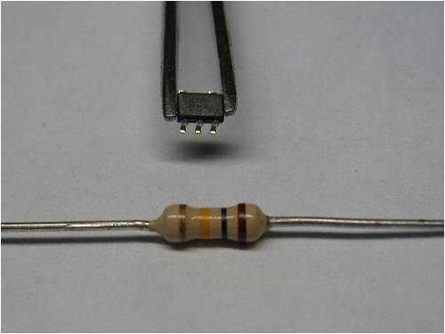

Smd chips make me marvel at how tiny they can be and the job they do.
Until you drop one on the floor as i just done and spent the next hour looking for it.
It was a shunt monitor chip, and this tiny little package can read a shunt with 100 amp flowing through the shunt and up to 80 volt.
It amazes me till it comes to soldering them onto the board.
The resistor in the photo is a standard 1/4 watt carbon resistor for size comparison.
The chip is sitting in my tweezers.
Now must get back to soldering it onto the board before i loose it again
Pete.

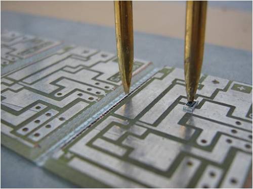

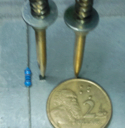

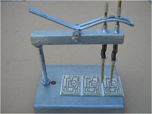

Posted: 06:30am 07 Jan 2011
Its not that we always have a choice on what chip package to use, as in this case these are the biggest size they are made in, and as time goes on we will have a lesser choice of what we can get.
I dont find them too bad to solder with a clean small tip iron, the hardest part is holding them in their location while soldering.
I developed a little gadget to assist with this and it makes the job much easier.
It has 2 spring loaded pins that operate from a cam lever.
Fully depressing the lever lifts both pins up so you can slip the board under and align it so the front pin is over where the component needs to go.
Then 1/2 depressing the lever lifts the front pin only so the component can be placed into position with tweezers, then the pin is lowered on top.
The rear pin stays on the board to hold the board in place.
As it now has a positive pressure on the chip, when the solder tinning is heated the chip squashes down into the solder, i normally add a small dob of solder to the leg just to ensure a good bond.
It is possible to also solder them this way with a quick pass of a butane torch flame over the legs.
Its like everything the more you use something and be set up for a job the easier it becomes.
I once hated the idea of working with SMD but now find it rather quick, and not so bad.
The hardest part now is etching the boards to a fine tolerance to fit the chips.
Pete.

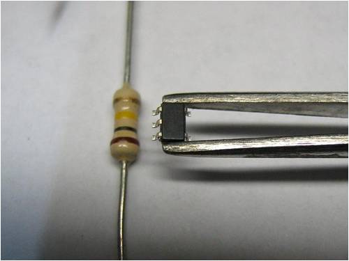

Hi Readers,
I have a v1.1 of Pete's 3rd hand smd clamp.
I have included a pic of a smd mosfet I had previously soldered by hand. This device has 6pins, and the pins are really close together. I normally just solder all pins and then use wick to remove the excess, as it is almost impossible to solder the pins individually. As Pete, has said, making a PCB with the tollerances for the tiny pads is a challenge.
This little device is a mosfet I have used on a picaxe for driving a SSRelay. This one has a 20mOhm ON resistance.
I use a pair of reverse acting tweezers to place a device under the pin and then guide the pin to the clamp position. I am yet to shim the pin to allow more precise operation, but the little clamp does help with all types of devices.
Gordon.
PS I have some smd zener diodes, that are 1/3 the size of this mosfet, but I was unable to photograph. These are even a challenge with the clamp. They look a bit like coffee bits in the sugar bowl.
