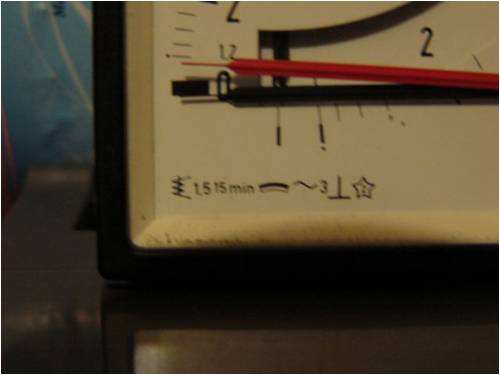

Hi everyone,
I was wondering if anyone out there knows what the symbols on the front of analogue meters mean?
Is there a web page which explains them?

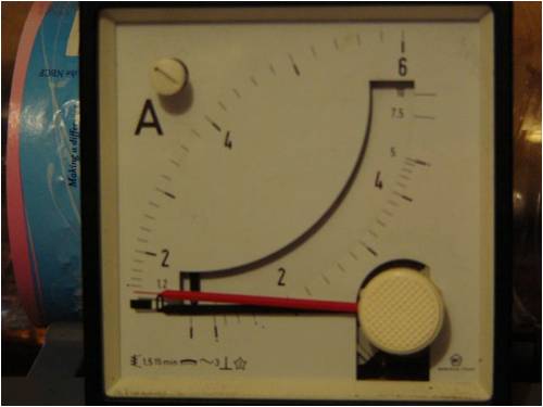

This is a maximum demand amp meter.
The markings 15min means the needle on the right is the average amps over 15min.
The red needle is the maximum amps ever recorded since reset and the needle in the curved windows is the current amp reading.
But I don't know what the other symbols mean.
I can not find any info on the symbols on the net so I was wondering if anyone else could help.

I think this is a bi-metal strip meter. The symbol that looks like a black and white line on top of each other, bent up in the middle, could mean bi-metal. The symbol to the far left could be its heating element.
Bi-metal meters are common for measuring current where a fast response time isn't needed. Most 20 year plus old cars use them for their fuel/temp guage, which is why the guage take a few seconds to drop back when you turn the ignition off.

Further to what Gizmo said, the symbol to the right of the bi-metal bit tells the meter is for AC, 3 phase, the upside down 'T' means its for vertical mounting only and the '2' inside the star says it has a 2KV test rating.
I have not come across bi metal meters for a long time, I might dig out my old text book I kept from technical college many years ago and refresh my memory what all these symbols mean. Nowadays with digital meters so common the symbols on analogue meters are becoming ancient knowledge.
BTW, I think the '1.5' means the meters accuracy, 1.5% of full scale deflection.
