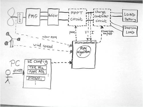

Posted: 03:14pm 27 Nov 2010
There are a few posts regarding wind turbine mppt spread across the forum.
Although there doesn't seem to be a common approach to a DIY solution.
The diagram shows a proposed solution for a mppt system :
where the user builds their own circuits depending on their voltage & current requirements.
These circuits can then interface to the microcontroller as shown.
Different control algorithms can be selected via the PC, such as maintaining constant TSR,
or full mppt hill climbing etc.
The algorithm output will determine the duty of the pwm signal sent to the user mppt circuit,
which in turn controls the load.
The microcontroller monitors the output power (V & I) so can determine when to switch to a diversion load,
and send a digital signal to the charge/load controller circuit to switch on/off.
So the user doesn't need to do anything else but make their circuits. The software is already written,
and the performance improvements can be viewed via the UI charts.
Any other ideas ...
GWatPE
Joined: 01/09/2006
Posts: 2127
Posted: 04:39am 28 Nov 2010
  dereksoftstuff said   the more I think about it, surely every windmill should have an MPPT as standard. Maximising the current to the batteries is what we all want. We want a windmill that produces more power for the same wind. ...
This philosophy is all well and good at low power levels. As soon as the wind energy starts to get exciting, [highly dynamic windmill behaviour] control systems seem to break things.
The block diag you have presented is typical of what a MPPTracking regulating component is required to do.
My own testing, and involvement in fixing commercial, small scale system installs and failures over the last 3 years has enlightened me to the power of the wind.
Electronic Windmill MPPT systems seem to go hand in hand with failures.
The most reliable windmill, that produces power proportional to the wind energy up to about 10m/s windspeeds is a good start. A windmill designed with a cutin of 5m/s, and blades and furling that limit power above 10m/s, coupled with a boost component that gives charging current in winds from say 2.5m/s and up, is another plus. The rotor blades are very forgiving when designed correctly to work with the power in high wind speeds. We may think that micro processors and our running control program are up to the task, but the windmill has a way of providing certain adverse power levels that let the magic smoke out of those so called within rating components.
At the end, the micro algorithm is part of a complex control loop, the power electronics being probably more than DIY. There is much more to this than saying
  dereksoftstuff said   where the user builds their own circuits depending on their voltage & current requirements
These circuits can then interface to the microcontroller as shown. ....
I back my opinions with real world data and observations from my original test windmill with an analogue boost MPPT and subsequent efforts on my new windmills to achieve similar results with digital processing MPPT using a buck and boost topology and capacitor doublers. Check my avatar of my own windmill in a storm.
If we stick to MPPT, and not introduce power transmission loss issues, then it is possible to make a buck windmill MPPT. Reliability will be the key and the complexity and sizing of components in the unit makes for higher cost than a boost cct for the same power windmill. In the buck cct, connected after the main rectifiers, the electronic MPPT has to pass the full power all of the time. In the boost cct, the electronic MPPT works in parallel with the main rectifiers, so only has to be approx 1/8 the power handling. In this arrangement, the boost cct may be required to work most of the time. My own windmill boost cct has been working since 2006, without any down time. It is all well and good to be able to build a windmill MPPT, but unless the wind reigime dictates power levels to justify the equipment needed then full power range MPPT is unnecessary.
I doubt that a windmill MPPT of the buck topology for power levels above 500W would be considered DIY. The equivalent power windmill with a boost converter would only need to handle 50-100W, and this could be considered a DIY project.
Gordon.
PS edit: I would opt for a MPPT algorithm to work with a boost cct, and compensate for the inertial mass of the rotor, and be able to regulate to a battery providing a battery maintenance function.
Edited by GWatPE 2010-11-29
become more energy aware
dereksoftstuff
Joined: 14/11/2010
Posts: 30
Posted: 09:44am 28 Nov 2010
Gordon
Glad you like my design. I'm working on it now.
You're right, the microcontroller you are using can not do the job adequately.
If you get a chance - try one of the cortex-m3 arm microcontrollers.
There seems to be a lot of talented DIY'ers here on the forum,
so building circuits for their wind turbines is within their gift.
With this design, everyone could measure the performance of their system (no mppt). Then add the mppt circuit and measure the performance again and compare results. Then try a different 'mppt' algorithm and compare results again ...
So it will be very easy to see what works and what doesn't, as well as posting video evidence for everyone to see.
The beauty of having a reliable performance measurement system, is that you can modify anything you want on your system and see what difference it makes.
If you've had some experience with different 'mppt' algorithms (wrt buck/boost topologies), could you specify in more detail (inputs, algorithms, results) with any successes/failures.
I'm interested in everyones input for things you'd like to be able to measure on your wind turbines, and ideas on displaying/comparing the results on the PC.
GWatPE
Joined: 01/09/2006
Posts: 2127
Posted: 10:06pm 28 Nov 2010
I am sorry in not replying sooner Derek, but I had used up my daily posting limit.
  dereksoftstuff said  Glad you like my design. I'm working on it now.[/Quote]
I don't think that I said I liked your design anywhere!! I merely stated that this block diag is along the lines of what a MPPT component would do.
  dereksoftstuff said   You're right, the microcontroller you are using can not do the job adequately..[/Quote]
I have made working MPPT for my windmill, of the boost and buck variety with a micro as the PWM control element. The micro program is not the only problem.
  dereksoftstuff said   If you get a chance - try one of the cortex-m3 arm microcontrollers...[/Quote]
I am in the process of aquiring an evaluation board at the right price.
  dereksoftstuff said   There seems to be a lot of talented DIY'ers here on the forum, so building circuits for their wind turbines is within their gift....[/Quote]
The problem with building high power switching devices DIY, is most end up as powerful RF transmitters.
  dereksoftstuff said  With this design, everyone could measure the performance of their system (no mppt). Then add the mppt circuit and measure the performance again and compare results. Then try a different 'mppt' algorithm and compare results again ... So it will be very easy to see what works and what doesn't, as well as posting video evidence for everyone to see.....[/Quote]
I wish the real world was as simple as you make it seem.
  dereksoftstuff said  The beauty of having a reliable performance measurement system, is that you can modify anything you want on your system and see what difference it makes......[/Quote]
I agree that having an accurate and responsive recording measurement system allows educated decisions to be made. I have such a system on my own windmill/RE setup and it has allowed me to do just that.
  dereksoftstuff said  If you've had some experience with different 'mppt' algorithms (wrt buck/boost topologies), could you specify in more detail (inputs, algorithms, results) with any successes/failures.......[/Quote]
I have described at length verbally, and with pictures a lot of my own experimental ccts. BobShau has presented a boost type controller, even with control loops.
  dereksoftstuff said  I'm interested in everyones input for things you'd like to be able to measure on your wind turbines, and ideas on displaying/comparing the results on the PC.
If I ever get an evaluation board, I will check its potential. I suspect analogue sensors may be in short supply, but there is probably a work around. I am looking at sharing my own data between running apps, so this could work with the evaluation board as well.
Gordon.
