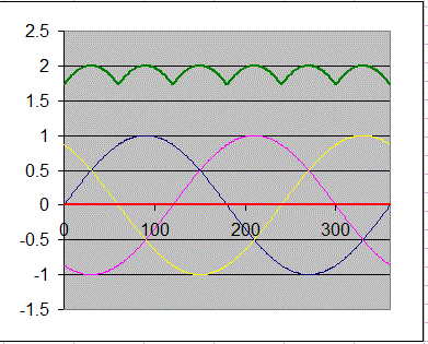

I guess what I am on about is hard to grasp for many, but here is a picture, that will help.
There are 3phase waves that most will be familar with.
There is also the 3phase full wave rectified, and the interesting flat red line.
My intention is to provide a loading similar to the flat line. The rectified waveform becomes highly asymetric with loading [especially a battery, or capacitive type].
I have tested a purely resistive loading on my windmill and the resultant alternator sound is silent, while if the waveforms are rectified first with the same resistive loading, the alternator develops hum.
Just have to get the electronics to do their thing now.
Gordon.
