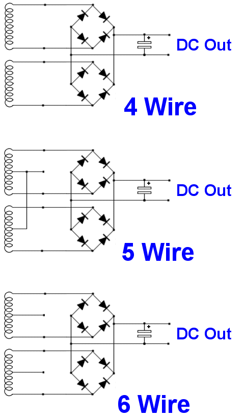

Here is a pic I found on the net sometime ago maybe it will help.
Bob
Posted: 03:15am 30 Aug 2010
As shown in the post from Bob the 6 wire motor will have 4 outputs used.
If you use your multimeter and check the resistance you should find 2 sets of coils.
Each coil having 3 wires, you want the 2 wire for each coil that gives the highest resistance reading.
The unused wire should give about half the resistance compared to the other 2 wires.
Pete.

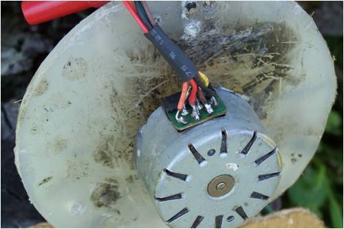

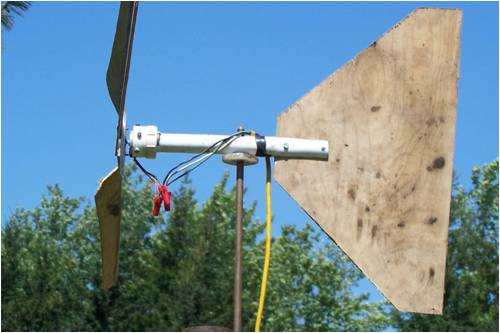

Posted: 03:34am 30 Aug 2010
Here is a photo of my 6 wire scanner motor; it and a 5 watt solar panel keep a 12 volt car battery up enough to run my led yard light.
The two phases are wired in series to bring the voltage up, in a good breeze it will output about half an amp.
Have fun
Bob

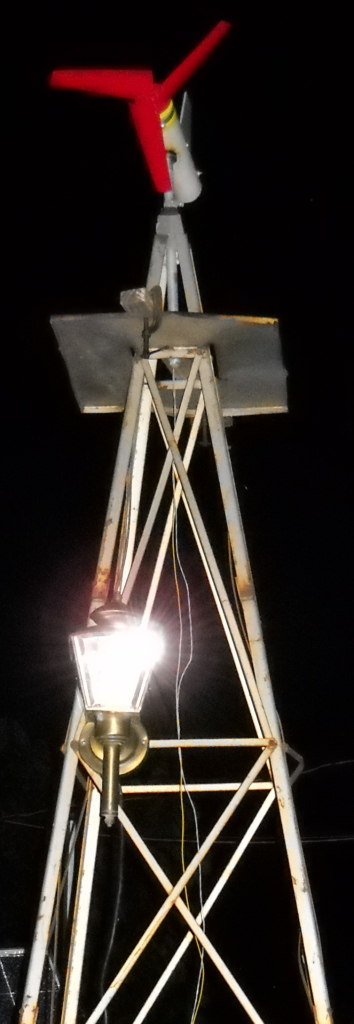

Posted: 10:32am 30 Aug 2010
Now the G clamp looks a little tacky Bob.
Whats the globe in the light, as it looks rather bright.
Pete.
Bub73
Joined: 10/12/2009
Posts: 116
Posted: 03:16pm 30 Aug 2010
Hi Pete;
The globe is a standard 110 volt led bulb that went bad and I converted it to 12 volt
and used jumbo led's and defused them by cutting the tops flat and drilling a counter bore into the flat on top; the camera flash may be reflecting off the reflector in back of the globe in the photo also.
