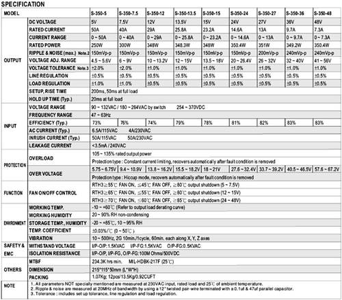

  VK4AYQ said  What I have played with is a conventional switch mode power supply that works on AC and DC input and is rated at 350 watts, at 300 rpm reflecting a 3 foot mill at 8 ms airspeed. With a star connection on the Alternator, three phase rectified gave 300 volts DC into the modified SMPS and full output.
My mills as planned are 3 ft in diameter 8 ft high and 4 ft in diameter 10 ft high with 6 airfoil blades 10" cord and symmetrical 20% thickness ratio non critical laminar flow, with vortex generators every 4" on the outer and inner surfaces of the airfoil.
While others have gone for the reconfiguring the windings to lower voltage for direct rectification to 12 / 24 / 48 volts I believe it is more efficient to use high voltage.

This is the spec of the SMPS I am testing with. the 27 volt unit.
All the best
Bob
