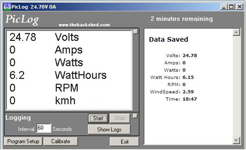

Well I've been working on the new Piclog version 1.5 over the last few weeks between paying jobs. The new Piclog has a lot of bug fixes as diagnosed by several forum members, special thanks to Gordon, Phill and Pete for pointing them out. I've also added the ability to send log data to a remote server.
To use the remote logging, your Piclog computer would need a internet connection with access to www.thebackshed.com. In the post above I said it would need a dedicated IP address, but this isn't necessary. The Piclog sends its data as a web page request every 10 minutes, and thebackshed.com's server saves this data into a database. Why 10 minutes? Why not every 1 minute? Lets do the maths. Say we use 1 minute intervals, thats 1440 records sent per day, 525,600 per year, for only one PicLog. If we end up with 10 piclogs sending data, then thats over 5 million records per year. While the database will handle that many records, its still a lot of data thats not really needed. If we send data every 10 minutes, we reduce this data volume 10 fold, while still having more than enough data for our graphs. I did do some experiments using 1 minute, 5 minute and 10 minute intervals, with the data overlaid on the one graph, and all 3 intervals display the same on the graph, though the 1 minute interval line was very fuzzy.

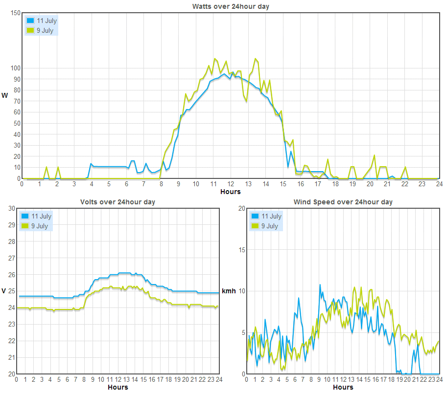

To display the data, I've using a Java graphing script that draws the graph on a web page. At the moment its displaying graphs for watts, volts and wind speed, over a 24 hours period. And it displays two days over eachother, making it easy to compare data from two different dates. More graphs will be added in the future. The graphs are live, so you can see how a windmill / solar panel / etc is performing at any time, from anywhere that has access to the internet. You could be at work and see how your windmill is performing during the day! Below is a set of graphs, display two days on top of eachother.

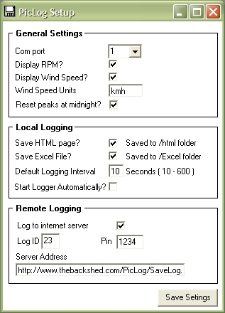

The Piclog software has a few changes. The Setup screen now has a option to reset the watt hours at midnight, the software will either reset the watt hours every night, or keep a running tally. I'll be adding RPM and Wind Speed peak recording as well. Also added is the remote logging options, where you set the PicLog ID and Pin, and server address. The ID and Pin will be provided by me when I set up the server to accept data from your PicLog.

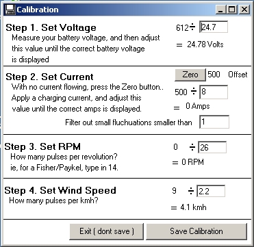

The Calibration screen now has a amp reading filter, to filter out small changes around 0 amps. These small fluctuations can cause tray watt and watthour readings, especially if you use a Allegro current sensor or current transducer to measure current.
If you enable the remote logging, the PicLog screen will widen to display a extra panel. This extra panel is a mini web browser, and is used to send the data to the remote server. It also displays the web page sent back from the server, confirming the data was saved in the servers database.
I've been running the updated PicLog and server software for a couple of days now, but I have a problem, as you can see from the PicLog screen above, no wind! So I've connected up my solar panels to act as a power source for testing, you can see the rise and fall in the watts graph above, as the sun rises and falls during the day. Problem is, its not much good for comparing watts to wind speed or RPM, one of the graphs I want to add. So I'm looking for a couple of beta testers, forum members who are running a PicLog on a PC with internet access. If your interested, let me know and I'll send you the updated PicLog software, a ID and Pin to access the server.
The PicAxe chip software is unchanged, so no need to reprogram it. Petes power logger will also work with the new PicLog 1.5

The graph test page is at http://www.thebackshed.com/piclog/Report3.asp. Its a pretty intense chunk of java, might take a few seconds to load the first time. Works better in Firefox than IE.

If you are looking at the graph, move you mouse over the points and it will display the values at that point. It will also display any notes the PicLog owner has added to a specific record.
