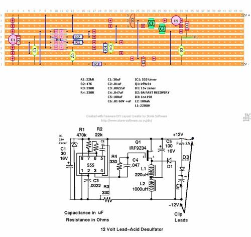

Has anyone layed out the desulphator circuit that downwind had posted? I am looking to make a few of these both 12v and 24v. Problem is I am not good with adapting a circuit to vero (strip) board. I ordered a bunch of stripboards from a company called futurlec. Note the prices were good, although I got charged a customs charge I didn't know I was gonna pay.

I haven't tested this layout yet but you are welcome to try it out. I'm sure others here will catch my mistakes and/or make it better.

pink dots are breaks in the stripboard?

I would read it as cut tracks, yes.
Be mindfull the inductors are not all small, and you might not want to restrict yourself to the size shown, and might need to miss a track here or there to allow for the physical size of things.
I have not checked the circuit lay out but trust Bob has got it right.
I cannot say i got outstanding results from this circuit on the battery i tried it on, but must it was a bad battery i had given no hope to anyway.

Yes the pink dots are track cuts and inductor size and style will effect spacing so be careful.
This is the first time I've used diy layout creator so there there could be mistakes; also I've added a couple minor components for a test point and a zenner to protect the 555 ic.

Hey i am trying to build this circuit at the moment and getting the parts is a nightmare.
I have finally sourced them now but i want to ask for future builds, how critical is the uf value of C1. That little capacitor nearly gave me an aneurism. The ones i got cost me $5.00 each!! Futurlec, altronics, Jaycar, Mouser and Digikey don't have them. Only Farnell @ $5.00 each in 250v or something.
Would it be possible to substitute this with a 33uf that are a dime a dozen?
Sorry for my component ignorance.
Even C4 was a nightmare not to mention the 6A inductor ($9.00 each) or the Mosfet.

C1 can be anything larger than specified, mostly just for filtering; I use 220uf @35v with good results because I have them.
C4 and the Mosfet I get from mouser.com or ebay; I think Mouser will ship Internationally.
C5 wants to be just as specified 100uf 16 to 25 volts low impedance.
