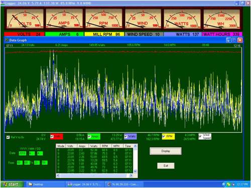

I modified Glenn's Piclog software and added in analog meters i have two versions of it
You can download both here, unzip and put both exe files in your Piclog Folder
2010-06-05_074519_meter.zip

Hi Windman
That is a great job for adding an analog meter and looks great and better for my eyes I also love analog meters. Well done Mate

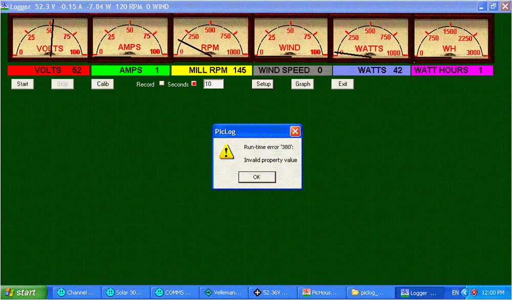

Hi windman,
I have been unable to run your program. It seems that the underlying bugs are still there.
The analogue meters are good, but take up a lot of space on the screen. I hardly ever use the real time window, as most of the time I minimize the app to the task bar. I have 6 other logging systems running when I tried to run this new prog.
You may have seen the error in this pic as well.
Gordon.

Yes I Have Seen That Error with the old Piclog and this New one all i do is Close It wait a few seconds And reopen It, It has something to do with the Timers in the Program i think , But It All Work Ok So I ignored the message and restated it some time a few restarts, i did get less errors if i had VSrcoll under timer 2 but i didnt like the way it would reset to 0 every few minutes.
Il look into this at a later time, as it does work now.

Posted: 04:24am 05 Jun 2010
I get the same error as well, and it keeps crashing.
I am unable to run it with incomming data.
It looks good in what you have done, my only dislike is how it takes up the full screen.
I like a small window that i can leave at the bottom of my second screen and view the incomming data while doing other things on the computer, as i use the one computer for many functions and data logging is just one function in the back ground.
If you can fix the bug let me know as i would like to view it with live data.
Pete.

ok i spent alot of time on this last night going threw the code and i could not see anything to cause that error 308 that some of you seem to be getting.
I remember that same error when i first used the orginal Piclog but after a few restarts it went away and the only error i would get after that was a runtime error now and then.
after i mod the picloc for the analog meters and debug all the problems out I did get the error 308 1 time only, but never got it again.
so I Loaded this in 5 diff computers all xp diff versions and put the MSCOMM in the system32 and then open the new logger, 3 computers no problem at all 1 computer gave me the 308 error 1 time and never again, the 5th computer i restarted the logger a bunch of time but it would not run with out erroring out (308) error, Ok i have 4 computers that the new logger has no problem running and 1 computer i cant get it to run with out erroring out,
Ran a Registry Cleaner And now The 5th computer runs the new analog logger with no problem, but i dont have any of the 5 computers hook up to com port for data.

I would like to know how many are having the 380 error problem, and how many are not having any problems and if you are but you can get it to run then try , unclick. startup auto in programs and unclick html ,excel,rpm,wind.
rpm and wind donot disables meters or enable them.
EDIT: Maybe I just found something but not sure try this one and if you dont get error let us know and the some admin can delete the upper download or replace this one with it.

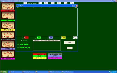

Heres The Newest Fix? I change the Sub MSComm1_OnComm() That Glenn Posted Above And They Still Work For Me No errors, So See If It Erros For Any Of You Guys.
And i Noticed the Amp Meter Neddle Was To low In The Center So i Fix That To.
