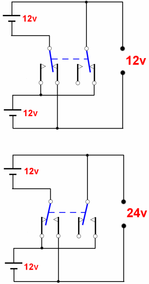

Here's a circuit I've used before for switching two 12v batteries from parallel to series. Uses a single DPDT toggle switch, or relay. The contacts should be break before make, or you will get smoke. Most switches and relays are break before make, its only the specialty stuff thats make before break.
Bobs advise on 24v is good. 24v might give you a tickle if you have wet fingers, but it cant hurt you, and 24v inverters are good value.

Thanks to all.
I've been bitten enough by electricity to have a healthy respect for the stuff. I'm so cautious, I even retest 240-volt a.c. circuits that "I" have opened when changing out electric water heaters (I'm a plumber in real life). Even knowing things are off, i have a hard time sliding that little metal nut thingy over the bare ends of the wires when I have to change out the romex connector!
When it comes to electricity, I think I'm perhaps somehow genetically related to that large, flightless bird, the chicken!
I think I'll take both your advice and consider the 24-volt gig. This post goes into my "Thebackshed.com Saves" bookmark folder for sure!
