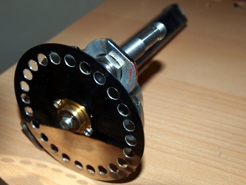

at the moment i,m building the piclog logger circuit...the board is finished and i,m
starting to think about making the anemometer whitch is a lot of fun

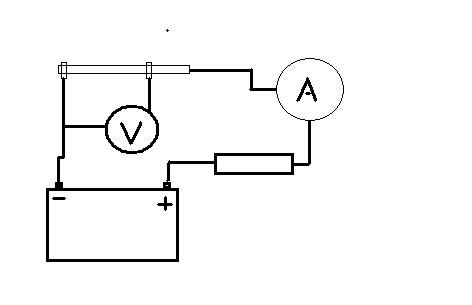

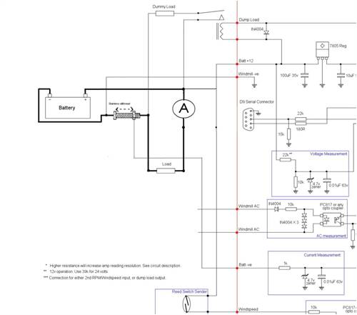

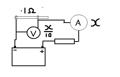

however the shunt i,m still a bit confused about...accessing the .1r resistor is a bit expensive here so far so i,m wondering about using stainless allthread in its place
the stainless would need to be calibrated in some way and heres what i was thinking off doing
the diagram isnt that clear but i was hoping to put a load on the battery with an ammeter in series then watch the reading ..at the same time the allthread could be adjusted to let the pic come into line with its reading ?
i,m not much good with ohms law so would this work ?....it might make a cheap shunt from recycled stuff ..

You only need the amp meter, the load as you describe, and a voltage meter across the all thread.
For a given current, your voltage drop will be a product of the resistance across the allthread.
So, if your load was say 5 amps, then you adjust your allthread to have E=I X R or .1 X 5 = .5 volts. So adjust the all thread to give you .5V and you will have your .1R resistor.(keep an eye on the amp gauge and calculate accordingly if it moves at all while you adjust your allthread)
Or if the load was 1 amp, then the voltage drop across the allthread when at .1R will be .1V etc etc.

Hi Niall,
Just one thing to add as Oz has given you a setup method.
It really wont matter greatly on what the calibration of the shunt is as long as at maximum amps the voltage dont go higher than 4.5 volts, it can be lower but not higher.
The max. voltage needs to be lower than the rated voltage of the zener.
The actual calibration is done in the piclog software so it dont matter what the shunt calibration is.
The picaxe will convert the shunt voltage to a digital value that will have little bearing on the shunt voltage any way, other than a linear digital value up and down in respect to the shunt voltage.
You might find the the value from the picaxe will fluctuate as shunts are a rather noisey device.
To calibrate piclog all you need to do is take the input value shown in the calibration window and divide it by the actual amps shown on your meter, the value of this is what you need to enter into piclog in the calibration box.
Pete.

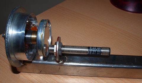

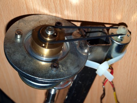

its just an old video head assembly with a prox sensor tagged on underneath
testing the pulse stream seems (i think) encouraging ..i can run it fairly low rpm
its a lot of fun Edited by niall1 2010-05-18

When I saw the rubber band I panicked.... but it is only for testing...
You can cut slots in the wheel to increase the pulse stream, and lower effective rpm limits. They are handy little gadgets. (may have to decrease gap width a bit for better sensitivity for more gaps).
What cup arrangement do you envisage for this project?

I have built a few of these now and find you really need around 30 or more pulses per rev to have something that will read worthwhile in any thing less than a cyclone.
Although if your targets/pulses is spaced very evenly apart then you can use a "pulsin" command (instead of count)and time the interval between pulses to get a accurate count with low pulse rates per rev.
Nice work.
Calibration is the hard part, unless you can borrow a bought 1 to work out the wind speed from.

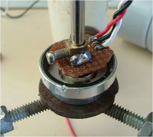

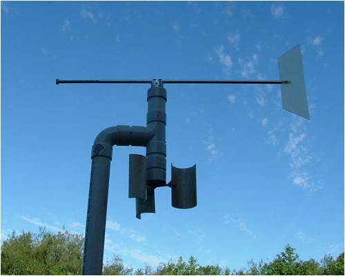

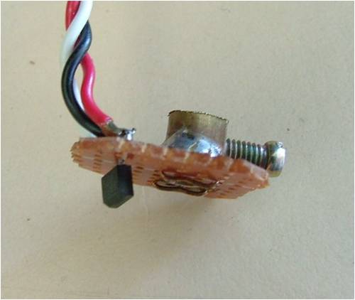

I built one recently using a motor from a old dead hard drive and a hall sensor from a dead PC fan. I used the magnet hub and bearings, discarded the stator, replaced it with a hall sensor. The magnet hub has 6 ceramic magnet poles, so I get 6 pulses per revolution. Its very ugly, I never meant to show anyone.
The hall sensor has 3 wires ( some have 4 ), 2 for power and one is output.
Below is the finished aneometer and wind vane. My cups are just PVC pipe cut in half, not as efficient as full cups but it seams to work OK, the bearings are good so its starts up in light winds.

looks good to me......if i can finish up with something that looks as functional as that i,ll be happy...i think i,ll try the paddles as well
Pete... i went back over the thread and seen that you could solder onto the platter so
i,m changing over to using that as well , i think i can leave out the flywheel head
section now and mount the platter with holes drilled around it to trip the senser
getting the most out of this particular sensor like Oz commented seems best know ...one platter might just be needed

just to erm..recap on this
say i set up the circuit above with a load that happens to give 5A draw (it,ll probabely be a bit different but not much)
so v = 1*r...12 = 5 * ?
so ? or r must be 2.4ohms ...something like a car headlight
i,m looking for about .1r shunt so ...5 by .1 is .5 drop so the meter should read .5v in the diagram ?
also if i,m reading this right it doesent matter if the supply is 24v ...as long the
voltage drop reading is a product of the amp reading and shunt resistance required ?
Edited by niall1 2010-05-25
niall
Posted: 01:18pm 24 May 2010
I dont know if its a typo but this is wrong
[quote]so v = 1*r...12 = 5 * ? [/quote]
It should read .....V = I x R......or.... volts = amps x resistance
Also your circuit above is wrong to, where you have the wire from the amp meter going to the allthread end is wrong, and needs to be moved to the same point the volt meter is connected to, or adjusting the allthread nut will have no effect.
Correct this then..............
Look at it this way, connect you "R" being a car headlight or what ever and take a reading of your amp meter, now adjust the nuts on the allthread till your volt meter reads 1/10 of the amp meter value.
So if your amp meter reads 6.4 amps adjust the allthread till the volt meter reads 0.64 volts.
As OZ said above then check the amp meter again and if it has changed slightly readjust the althread till the 2 match.
The aim is for the volt meter to read 1/10 of the amp meter. (at 10 amp the volt meter will read 1 volt)
This will allow you to read upto around 30-40 amp in piclog as the zener diode will start to conduct at much less than the 4.7 volt rating, and personally i dont like the circuit for this reason, and think you will find it not acurate as the amps increase.
Pete.

The shunt as used in the original piclog project, and calculated out at say 0.1 ohms as you are going is OK for high voltage, low current applications, but for a 12V system, you can surely see the problem with power lost, just to measure the current. I raised this a few years ago, and don't remember all of what was said. I could not justify wasting 10W out of every 120W at 10A, and 40W out of 240W at 20A, just to measure current. You need to get a higher sensitivity current sensor. The sense element [shunt] should be at least an order of magnitude lower resistance, and this will require an amplifier to make better use of the ADC input on a micro.
I would use a shunt with low temperature drift, and it would have a sensitivity of around 50mV for 50A. This will require an amplifier with a gain of about 100. This is a classic case for justifying a different sense element, like a HALL effect curent sensor. These can't be made from scrap though.

thanks....stuff dosent usually sink in very quickly...
edited diagram
should be able to try it out this week
niall

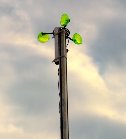

kind of finished the anemometer copying off the work done by
others on previous threads ,
i wanted to use the paddle type
arrangement but a last minute look around the local toy store
produced some "comet balls"... not to be confused with the "led balls"
on the shelf above if your a kid..
the mind boggles...
the cable run is very long ...so i tested the signal back to the pic at 12v and
it seemed ok , i can put a medium led on it and watch it pulse away i think it,ll
run the extra 10m to get it up on the the mill mast ...

Posted: 03:43am 29 May 2010
You say 12 volt back to the picaxe???
I hope you are not feeding 12 volt into the picaxe pin.
You will need to reduce this voltage to no greater than 5 volt input to the picaxe.

Nice job mate I am a bit curious as to how you got such a high voltage.
Before you put it up it may pay to give the plastic cups a few coats of silverfros paint to retard the UV degradation a bit as they may not be UV resistant plastic.
All the best
Bob

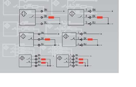

Posted: 03:15am 30 May 2010
Hi Bob,
Niall used a off the shelf proximity sensor and most of these work on 12 -24 volt, so i am guessing it is why his signal voltage is 12 volt.
Pete.

Posted: 09:59pm 30 May 2010
hi Bob/Pete
i dont know much about these sensors but as far as i can see they
output a signal of equal v (or close) to whats supplied possibly even enough to
drive a small relay (but i,m not sure about that ).....this signal
goes to the opto coupler through the matching resistor on the pic cct
the cups are soft plastic alright and mightn't even keep their shape
very well , as well as degrade so a couple off coats would be a good thing
