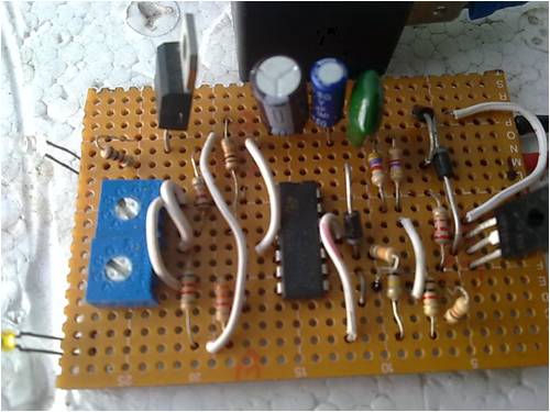

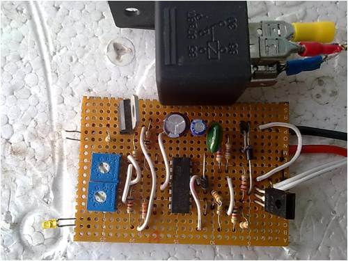

mr inventor, i want to thank you first for your simple ( not yet to me) tl084 controller.
please help me with the folloing point....
1.where should i connect the veriable ps?
2.power led always 0n?
3.high trimpot does nothing.
when i connectec the circuit for first time with high trimpot cw and low tp to ccw the green led lit after connecting vps at 15v.when i turn down the high tp to ccw it does nothing.
i left the htp to the end cw point.
now i turned low tp to cw and dump led lighted.

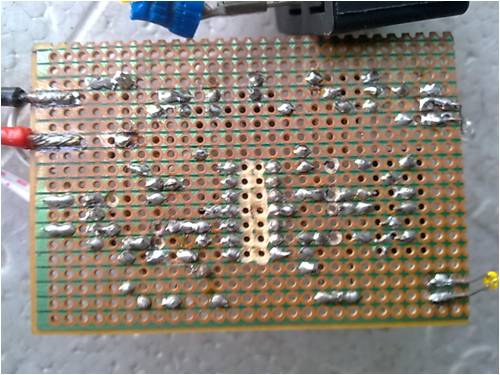

i think there is a big mistake when i soldiered the board
can you be more specefic=elaborate with the adjustments in simple english?
one more thing what about the different resistor value with different pages through the site(i am a novice )
http://www.thebackshed.com/windmill/articles/TL084-Controlle r.asp page was my guide but i could never found a second 12k as mentioned in the parts list.
circuit diagrams are complex to me when i only can copy assemble parts on vero boards.
i dont know how to talk polite in english or the topic may be very old or may be in wrong place of post...i need help.
thank you.

Hi amaridnai,
Welcome to the forum.
Ahrrrrrrrrrrrrrrrrrrrrrr!!!
Excuse me but another problem with this circuit.
I have helped a few now and it is always a constuction fault and not a design fault.
Lets see if we can help sort your problem out.
I commend you on posting some photos along with the question as at least we have something to work with.
As for the 12k resistor, the vero board layout is right and there had been some minor changes of late made and am guessing Gizmo forgot to update the parts list when updating the layout design.
The last thread that related to a problem with this circuit build is here.
http://www.thebackshed.com/windmill/forum1/forum_posts.asp?T ID=2382&PN=2&TPN=1
Page 3 i and others posted some voltage results for each pin of the opamp and you might like to read a bit and do some voltage tests of your pins to give a beter idea of where your problem lies.
In the mean time i will try to digest your photos/circuit.
Pete.

Is the jumper missing between pins 7 & 9 ?
Also I like to use a socket for the ic; helps to keep the heat and static off the ic during construction.
Will look more later
Bob

bub73 thanks for your comment.
in the original circuit there is 11 jumpers in my circuit also has 11.in my area no good parts seller so no ic base.
may be i should try to make another .as i am unemployed it will take some time.....
