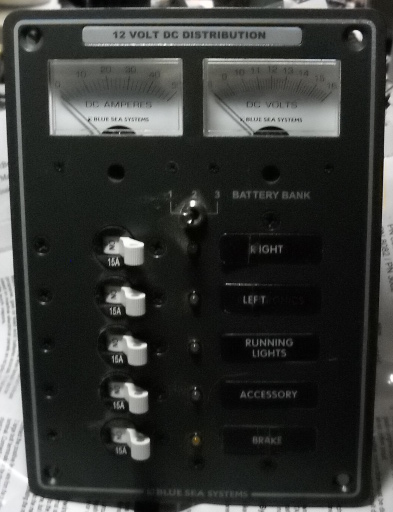

I picked up a Blue Sea DC Power Distribution Panel Model PN 8081
( www.bluesea.com. ) at a swap meet in the rain and when I got home I discovered it needed a shunt to make the amp meter work according to their instructions.
I contacted the manufacture and they replied that the shunt unit would cost about $16.00 more than I paid for the panel.This is too much for my budget So Im wondering If we could build in a inductive pick up for the amp meter? Something like the 8 & 9 n ford tractors used.
The panel has the volt meter and a Amp meter in it but the amp meter is not hooked to any thing.www.bluesea.com.
Im planning on using this panel in conjunction with my charge controller.
Any help will be appreciated.

VK4AYQ
Joined: 02/12/2009
Posts: 2539
Posted: 08:22am 11 May 2010
Hi Isaiah
You can make a shunt out of a piece of 1/4 inch threaded rod. feed the main current through the rod from one end to the other a piece about eight inches long should work ok feed from end to end termination for the main power and connect the ammeter to the feed in end and place several nuts on the rod to terminate the second lead from the meter a short distance away, start with the meter leads close together and move them slowly apart to calibrate the meter, use a multimeter in series on the 10 amp scale to calibrate and a load of as close to ten amps as you can.
All the best
Bob

Foolin Around
isaiah
Joined: 25/12/2009
Posts: 303
Posted: 01:26pm 11 May 2010
Thank you both for the reply and picture.''

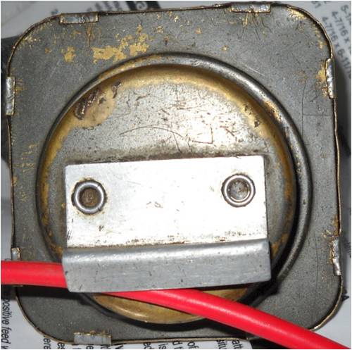

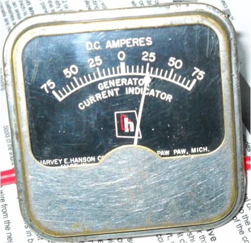

Bub73
Joined: 10/12/2009
Posts: 116
Posted: 05:43pm 11 May 2010
Hi all
Here are the pictures Isaiah was talking about. His panel and my old induction pickup meter about 50 years old and still very useful.
Sorry Bob no battery's required, I don't know just how it works but it always has.

isaiah
Joined: 25/12/2009
Posts: 303
Posted: 03:45am 18 May 2010
Ok it seems we lost interest on this subject . Today I was parting out a old
Sears & Roebuck lawn mower and noticed it had a amp meter that works like Bubs test meter. This mower I dont think was over 10 yrs old. I have the meter but is in rough shape due to being out side the last several yrs .
There is just a piece of steel( Tin ) that is formed with two small slots to go over the lugs on the meter then it is formed like a piece of tubing to hold the wire. The wire just lays in this . If any one is interested Ill see if bub will put up some pictures of it. Looks like a easy way to hook up a amp gage?

VK4AYQ
Joined: 02/12/2009
Posts: 2539
Posted: 04:02am 18 May 2010
Hi Isaiah
I have seen these type of ammeters over the years and the ones I have used where an indicator rather than a measuring device as the accuracy wasn't to good, the inductive principle they work on can be really good under controlled conditions but that's not the case usually,and the quality of the cheaper units is a bit suspect. They are more of an indication of current flow direction than a measurement of absolute units.
ALL THE BEST
Bob
Foolin Around
SSW_squall
Joined: 20/03/2010
Posts: 111
Posted: 02:04pm 18 May 2010
I recently took apart the current meter in my old Mcormick international tractor, and i think it uses a compass needle like that one in the photo above...
The DC magnetic field around the cable repels or attracts the permanent magnet that is the needle.
