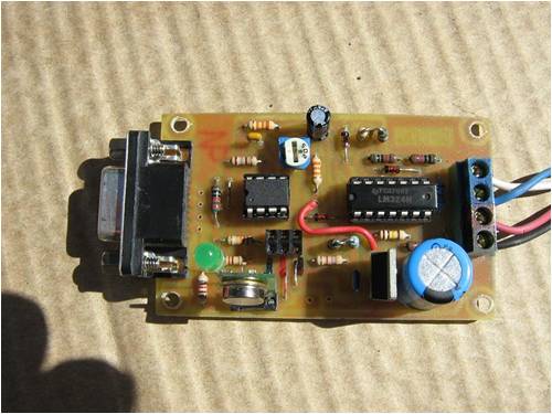

Heres a photo of the prototype board.
Pete.
powerednut
Joined: 09/12/2009
Posts: 221
Posted: 10:34pm 08 Apr 2010
Hi Pete,
Yup, currently my set up is solar only. I do plan on having a wind turbine in the near future though. The hall effect sensor will still work for AC.
The prototype certainly looks simple enough - congratulations on a very elegant design
