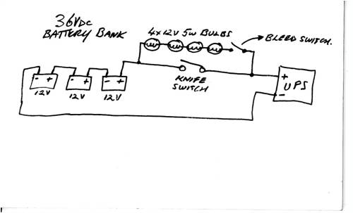

you could fit another switch across the knife switch
in series with a suitable light bulb. This will allow
you to bleed current into the UPS until the bulb goes
dim, then engage the knife switch without a bang.
sPuDd..
It should work ...in theory

I don't know what the cap reference is for.
A 36Vdc UPS & battery bank would be happy with 4x 12V car bulbs in series. A picture is worth a thousand words:

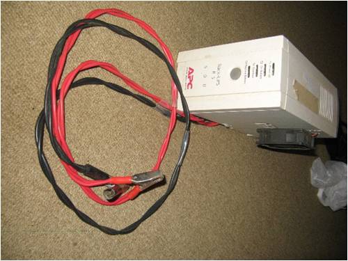

Actually UPS make quite good inverters:
We've had a couple of the desktop APC unit fail in such a way that the battery charging part of the UPS stops working but the inverter bit still works fine...
So i've extended the battery leads, chucked an 80mm PC fan on the side of the case to keep it cool and i have 200w of power on tap where ever there is 12v available!!
These small UPS's have a square wave output, but it can still power heaps of stuff: incandesacent lights, CFL's phone chargers, laptop's ect
Used it when we went camping on kangaroo island earier this year, (used the car battery as 12v power)
Even used it to run a small cheast freezer when the wife's uncle moved house and the twits at ETSA couldn't put the power on for a day or two...

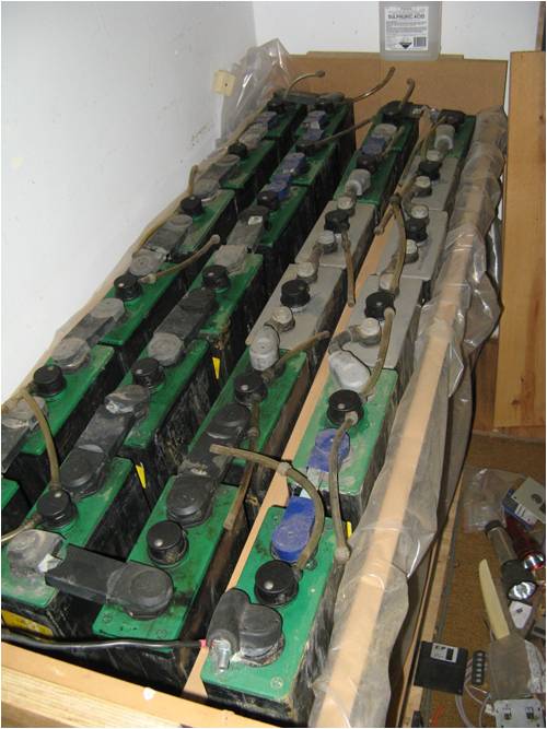

I have it hooked up to a 48V 620Ah battery bank that i got 2nd hand from the electric forklift at work.
The bottle at the end of the bank is just water, NOT sulfuric acid

Those batteries look like 2V lead/acids and may not be SLAs. If so, I noticed the charging voltage of any UPS would be lower or too low for lead/acids as they normally meant to charge SLAs and SLAs appear to get charged to a lower voltage.
How did you get around that problem or is it not a problem anyway, as the batts are really SLAs??

The batteries i have are the flooded or wet cell type, not SLA's. As you may be able to see in the photo there is plastic sheeting under and around the bank to preavent any acid spills from damaging anything.
At the moment the UPS keeps the battery on float at approx 55.4v with out any problems (13.85v refered to 12v battery).
This is a normal float voltage for both SLA and wet cell types at nominal temp of 20deg C.
The battery bank is inside downstairs such that the temperature is more stable, as batteries perform best when kept at a stable temperature.
I have a rectifier/filter caps that i can connect to my GMC stick welder to push 10A or more into the bank.
This allows the voltage to be increased to 57.6v (14.4v refered to a 12v batery) absorb voltage or even higher 60v which is the equalization level.
The bank really starts fizz at these voltages, not a bad thing to do once in a while: de stratifies the acid, reduces suphation...
