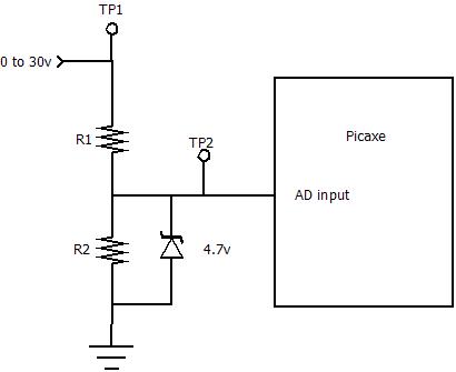

OK. I am usig a Picaxe chip to monitor a 24v battery bank. Using the circuit below.
Frig, I dont believe I have to type all this again.
R1 is 47k, R2 is 8.2k. The zener is to protect the chip.
The whole things works like the Piclog data logger. The AD input value is fed to the PC, that in turn uses a multiplier value to display the correct reading on the PC screen.
To calibrate it, I fed 20 volts in, measured at TP1, and adjusted the multiplier to display 20v on the PC. I then adjusted the voltage down to 18v, measured at TP1, but the PC displayed 18.7v! 22 volts at TP1 displays as 21.4v. So its not very linear, useless as a voltmeter.
Another test, this time with my multimeter on TP2. Adjusted the input voltage to read 2.5v at TP2, and adjusted the multiplier to display 2.5v on the pc. Adjusted the input voltage to read 2 volts at TP2 and it read spot on 2v on the PC. In fact, it was dead accurate from 0 to 4.7 volts.
So it appears as though the input impedance on the Picaxe changes with voltage. As the impedance changes, it upsets the voltage divider and gives a non-linear response.
Has anyone else come across this, and knows of a way to get around the problem without adding a op-amp. This also means the Piclog may not be very accurate at any voltage other than the voltage is was calibrated at.

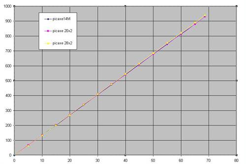

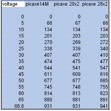

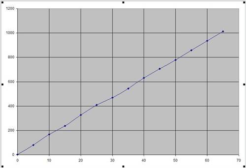

I have just checked my version of the piclog, that PhillM has a couple of as well.
The resistors on my cct are 56k, and 4k7, with a 4V7 zener protection. I only use the SMD version of the picaxe08M as you know.
Here is the output ADC counts v input voltage, and plotted on EXCEL.
The unit is linear within the limits of the chip. I could extend the range, all the way up to 60V. I use 27k, and 2k0 resistors now, and the linearity is slightly improved. I can't see why you are having problems, but maybe the socket???

Here is the graph, of the same cct, extended to a measured 65V input. As I said before, I see no problem.
Gordon.
PS Edit: There may be a problem with the supply to the chip, as the ADC reference is the 5V supply.Edited by GWatPE 2010-03-01

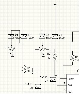

Below is a circuit I use for measuring 24 volts to an input ADC on a pic. I use 2off 10V zeners in series then a 10K pot for the fine adjustment, the 1K resistor protects the input pin and the other zener is there to clamp the input to 5 volts incase of a over voltage situation.

Hi Bryan, the cct you posted, gives an expanded scale voltage window, but zeners are reasonably noisy components. If the cct works, then this shows that the Pic input has quite a low impedance, as the only ground path for the input is within the chip. It is usually better to scale the voltage externally, and not rely on the internals of the ADC in the chip.
Gordon.

I like Bryans idea of series zenners to give an expanded scale.

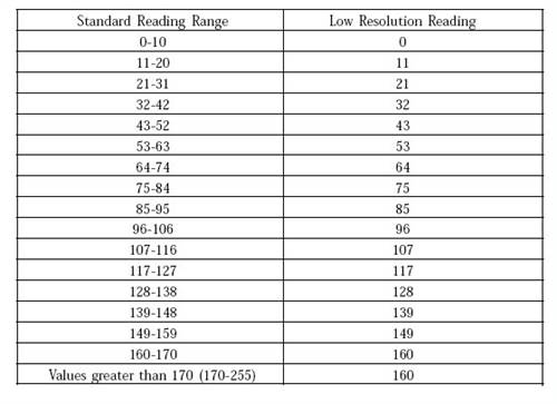

Posted: 11:39am 02 Mar 2010
Looking at the picaxe data the adc steps in 16 steps and from the chart i dont see how it can be exactly linear.
Correct me if im wrong.
Pete.Edited by Downwind 2010-03-03
Posts: 5200
Posted: 11:55am 02 Mar 2010
That would be a the low resolution READADC command, with 8 bit resolution. I'm using the 10 bit readadc10 command, gives 1024 levels.
