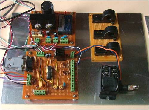

I've been building a new logger / controller based on the Piclog. Its using the new 20X2 Picaxe chip, and will be used at a remote 24v site with one of Phills windmills.
It will log wind speed, wind direction in 30 deg increments, battery volts, windmill current, load current and dump load current. It will also be measuring 3 additional 24v feeds from other equipment. The unit will act as a dump controller, based on the setting of two trimpots ( one for high volts and one for low volts, similar to the TL084 controller ). A mosfet output is used to drive a 60amp relay to switch the dump load.
I'm using 3 old current transducers instead of Alegro sensors. The transducers have a gain and offset adjustment, making them easy to set up and give a higher current resolution for logging, though they do require a +-15v supply.

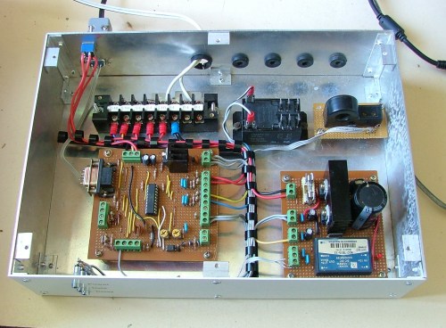

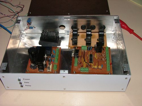

Today I built its box. To save a few bucks I thought I would make the box from scratch. I used the guillotine at my work place to cut up some scrap aluminum for the sides, top and bottom, and used some L section to pop rivet it together. It took about 2 hours to make , next time I think I'll just spend the money and buy a box from Jaycar.
Its 300mm wide, 210mm long and 70mm high.

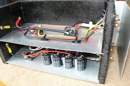

OK, the mega-Piclog lives again. After sorting out some non-linear voltage readings ( See - Measuring voltage with a Picaxe ), I'm pretty happy with the way its performing. There are a few small issues I want to sort out, but nothing that will stop the project from proceeding.

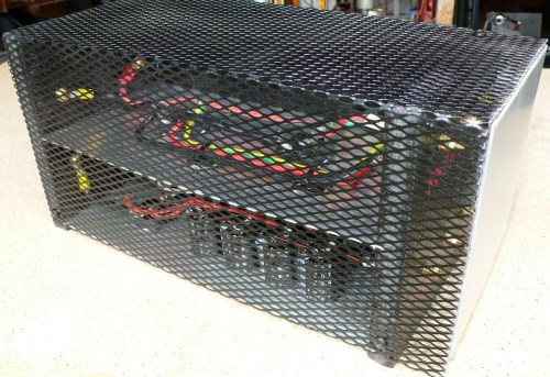

There is a dump load, but no pictures of that. Its basically a old PC tower case with some fans and a dozen 50 watt down lights mounted inside.

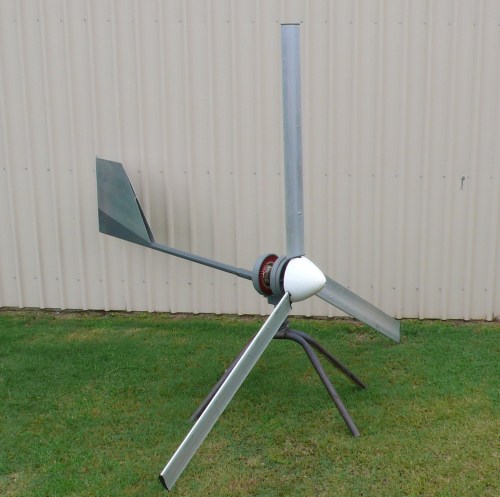

Phill has finished the wind turbine, its ready to fly.
And he's also finished the rectifier and voltage doubler, looks good.

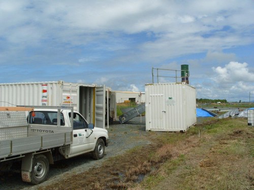

This is the site. The windmill will mount to a tower, not shown, that will mount to the corner of the shipping container to the right. The guard rail is to keep workers away from the tower and turbine, its only going to be a couple of meters above the container roof.
The containers contain a BioChar burner, a self powering charcoal factory. You feed in organic waste and out comes charcoal to use in the field. More on that later.
