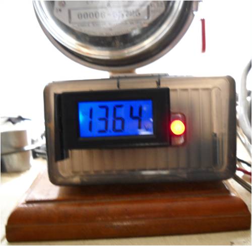

I'm building my 4th one on project board. I have substituted a hong kong volt meter instead of the power led.
All worked well so far except for one faulty new TL084. I did omit a jumper on the TL084 once and it took me awhile to figure out what I did wrong.
They do work nice.

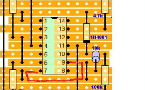

My board layout is different than the one posted. I have pictures here to post of my prototype but before I do, perhaps you could help me figure something out. The posted picture of Gizmo's vero board layout shows pins 1 and 8 on opposite sides and opposite corners of each other on the op-amp. My attached photos show the manufacturers pin outs as being on opposite sides but on the same end of the IC (if 7 is bottom left, then 8 is bottom right). I realized this might be a mistake on the posted vero board layout when I started comparing the schematic to the vero layout. Am I missing something or is the posted vero layout incorrect? Before I start posting all my pics, I thought this might be a good starting point for my troubleshooting. Thank-you for your help so far, I look forward to your response.
Georg

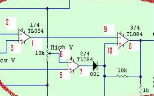

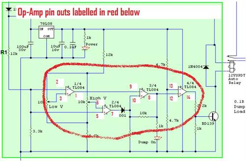

Just to add to my previous post, I have attached a copy of the schematic and have added the op-amp connection pins to it. When compared to the vero layout the pin outs just don't make sense to me.
George

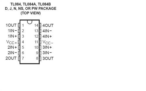

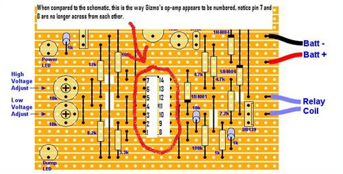

Maybe this will help; I think you got it numbered upside down looking from the top side.
Pin 1 should be the first pin on the left near the red arrow in your first pic.
I could be wrong lets see what Pete has to say.
Bob

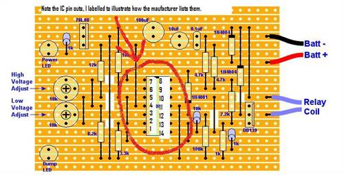

The veroboard is definately correct. I think you've come across some bad manufacturer data or are looking at the pins from the underside of the chip.
I've added the pin numbers to this copy...
This is looking at the component side of the veroboard. the copper tracks are on the other side. Below is a photo of the working circuit while I was prototyping it. I've marked the IC pins. Note the IC legs are facing down, away from you. The IC is in a socket in this case.
Let us know how you go.

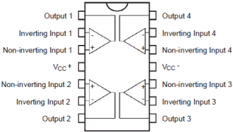

Gizmo is correct with his pinouts.
If you follow the schematic you cant go wrong, it will make no difference which of the 4 opamps in the package is used in what order as long as they are used in sets.
The reason i asked for a photo was to see what you have used where to solve some confusion.
I think it could be handy if Glenn also numbers the schematic pins as you have done, it will make construction easier for the novis and trouble shooting easier for the rest of us to referr to a pin in text.
If you have wired the board as you have labled the schematic it should be correct if you have worked to the pinouts as per the diagram that Bob posted, which is the same as Gizmo posted on the main page.
Pete.

Great, I understand now about the vero layout. The first op-amp in the schematic is labeled 1/4, should that not correspond to pins 1,2 & 3 on the TL084 (labeled output 1, input 1-,and input 1+). On Gizmo's post the actual vero wiring in this case would be using op-amp 2, where the schematic says 1. Right? To try and explain better I have added Gizmo's pic, you can see that pin 7 and pin 9 are connected on the vero (connecting op-amp 2 output to op-amp 3 input). On the schematic it shows op-amp 1 or 1/4 feeding op-amp 2 or 2/4).None the less, right or wrong about the op-amp labeling, Pete is right it should still work.
George

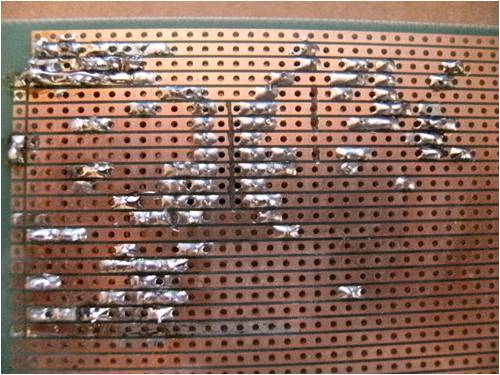

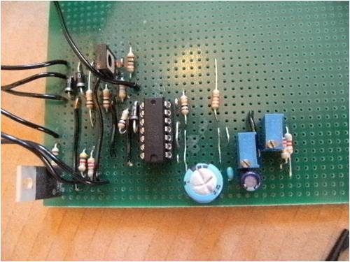

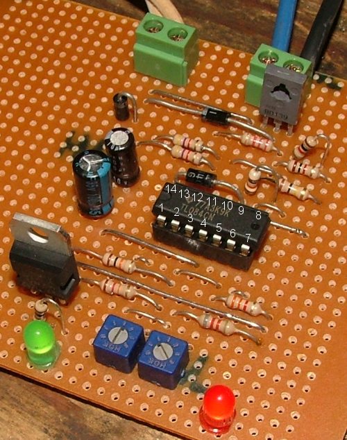

To add to my last post here are some photo's of the board. I apologize for any problems with resolution and will gladly re post upon request. I have toned out connections, as I am aware that my soldering may not be the best. Excuse the messiness. Please let me know if anything looks out of place.
George

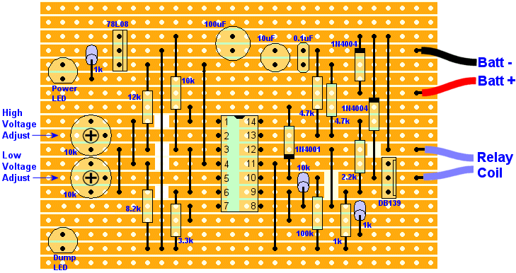

Gizmo has caused a little confusion between the vero board lay out and the schematic.
He has swapped opamp 1 and 2 around between the two diagrams, this should make no difference to operation if you had followed either one of the layouts but if you swap between the two then an error is easy made.
Looking at the bottom of your board there looks to be some heat stress on some of the tracks that would imply to me some short circuits on the board.(maybe some solder bridges between connections)
I can only count 12 cut tracks on your board and think there should be 14. (this might be due to how you wired the board)
Is there any reason why you did not follow the vero board layout that Gizmo has given.
Is that 2 different boards we are looking at in the photos as things dont look to match up.
Pete.

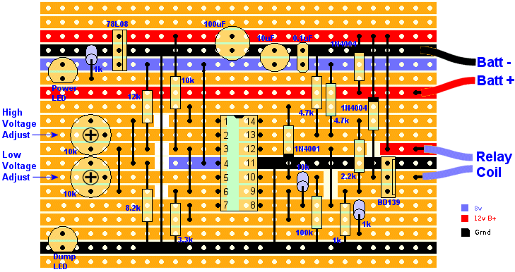

I can't follow them either, see if you got the basic voltages present I laid out in the image below. I hope Gizmo doesn't mind what I did with his image.
Its late here I'll check back in the morning.
BobEdited by Bub73 2010-02-13
Posted: 11:47am 12 Feb 2010
Hi Bob,
I dont think Gizmo will mind at the slightest, its good to have you involvement....Your image works for me.

If you follow Gizmo's mud map you cant go wrong, Its basically X&Y co-oords on the vero board.
