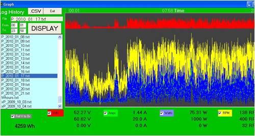

I assume you are quoting numbers for a Latronics PVE1200 ??
Here is some data from my own system.
This was from a reasonably good day, with > 4kWhr back to the grid.
The max power was about 800W, and the max battery voltage was 60.62V. The windmill/battery protection is set for approx 62V. The inverter is good up to 100V input. The battery/wiring at the up to 16A gives the spikes in the voltage graph. Grid connection was maintained and there was no dumping. If the windmill is shut down, then the inverter still maintains connection for up to 15min.
If yours is some other system then you need to explain some more.
Gordon.
