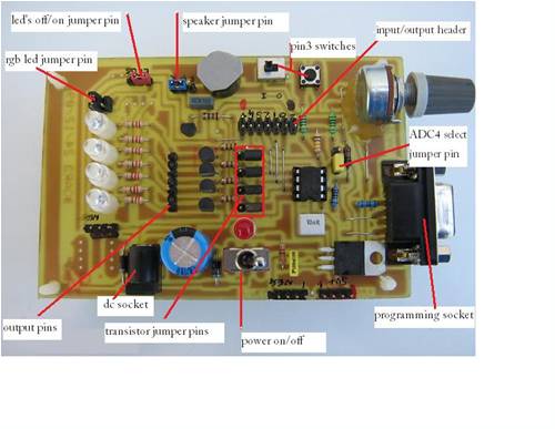

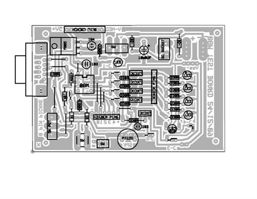

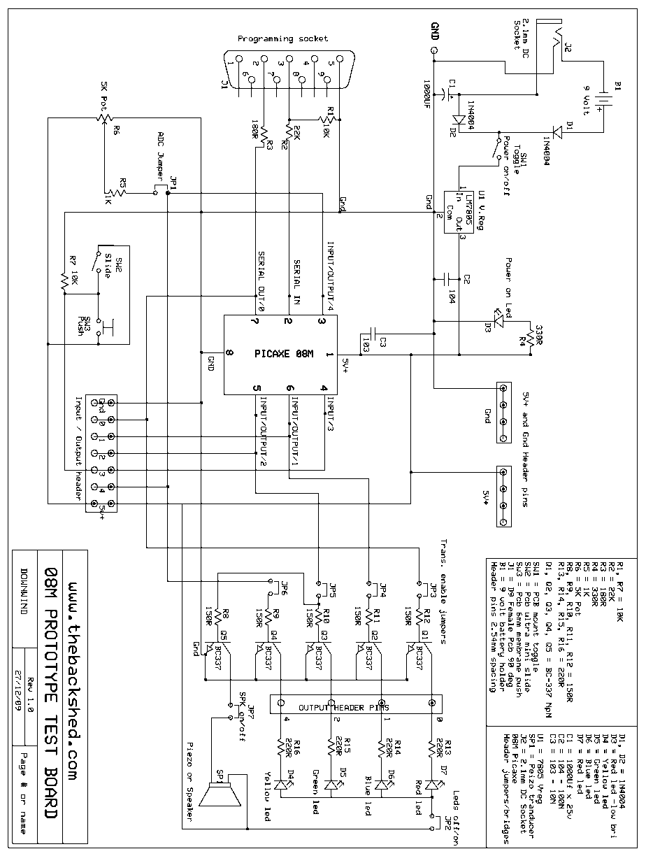

I have put together a circuit board layout for basic components needed and facilities to access all data pins so other circuitry can be easy added.
The artwork is in ExpressPCB format should you want to print it off.
ExpressPCB link here
2009-12-30_171906_08M_Prototype_test_board_no_rgb.zip
I have posted the board design above for those who wish to copy it and make their own , and will offer a small amount of pre made boards to those who would like to participate from the beginning.
If you intend to make your own board than I will ask if you can follow the same pinout connections as I have used.
Ie:- Output 4 for ADC pot, Output 0 – Red led , Output 1 – Blue led, Etc. that way if we all have the same for starters than the code will make sense to everyone and should work correctly for all.
It will also make error finding easier for the rest of us to help with.

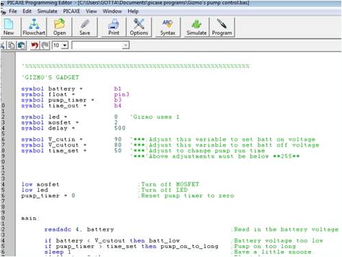

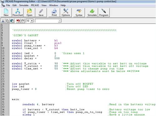

Above is a screen shot of the main window in programming editor.
It is a easy package to use with the Picaxe and it uses colour for the text to indicate what the commands and instructions relate to.
For instance all the text shown in Green is not a part of the program and is only there for human use as a comment description of what the program is about.
Any text after a ( ‘ ) will be in green and ignored by the program.
This is handy to remember should you want to remove a section of program temporarily than comment it out, by placing a ( ‘ ) in front of the line of code.
This is much easier than deleting and retyping it later. ( less chance of errors)

In the example above - Symbol Battery = b1 – This gives the Variable b1 the name Battery so we can now use the word battery in our program instead of b1, to keep the program reading in English. (you can still use b1 if wanted and will do the same)
There is some English words reserved for the picaxe instructions and can not be used as symbols, like- switch, pause, count, button, input, etc etc.
There can not be spaces in a word used as a symbol like , time out , so for this we use an underscore to join the 2 words like , time_out .
There is many other advantages to using symbols like above symbol time_set = 50 we have given time_set the value of 50 and every line used in the program after that has time_set used in it, is = 50. Lets say we used it 10 times throughout the program and we want to change the value of 50 to 100 then we only need to change the 50 up the top in the symbols = 50 and all 10 times in the program will change to 100 rather than going through the program and changing each line separately.
A symbol can be used to name a pin out as above Symbol mosfet = 2
This has called output pin 2 Mosfet so when the program reads – high mosfet – we know it is the mosfet we are switching on and not the led or something else.
We could just say high 2 and this will do the same but after several lines it gets messy with what the $#@% high 2 was.

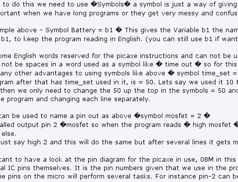

One thing in your detailed information above puzzles me though, there are lots of black squares on edge with a ? embedded liberally sprinkled amongst the text. What does this stand for?
I use Windows Vista and assume its some sort of code problem?
Klaus
Posted: 01:23pm 31 Dec 2009
Hi Klaus,
Are you sure its not your eyes with the New Year cheer?
Looking at the text this end i do not see what you mean.( than i wrote it so any thing is possiable )
There is no enbeded code in the text that i am aware of.
I also use Vista so am a little miffed on this? and will wait to see if others comment the same.

This is what I see from Firefox under openSUSE Linux 11.2:
maybe you should use a normal " instead of �
Vasi
Edit:
Ah you are using that character for comments... (') this one between brackets...Edited by vasi 2010-01-02
