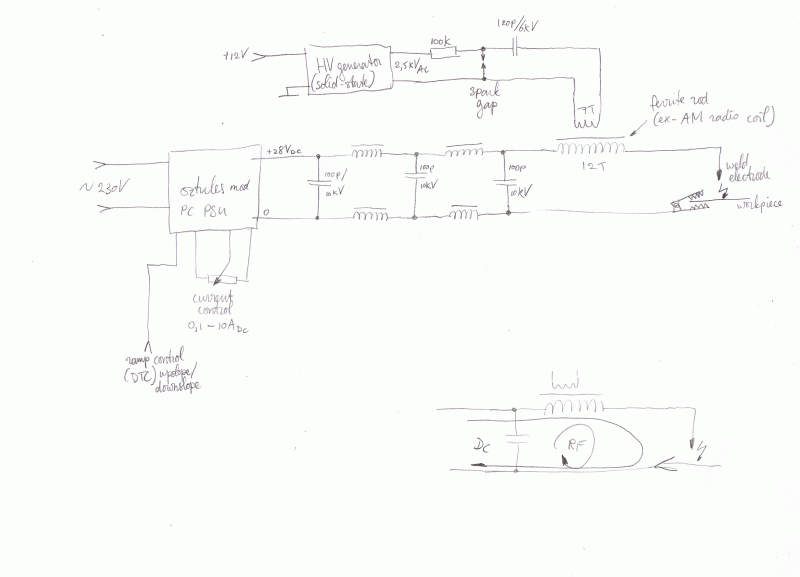

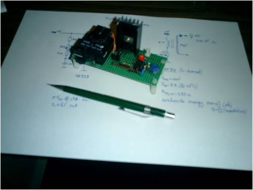

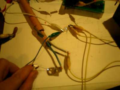

Just did some experimenting, not with the PC PSU but with the arc starting part, the high-voltage generator that superposes a RF high-voltage on the welding current. The trick is to add this HV without blowing up the PC PSU....
Below is the schematic, quickly thrown on a piece of paper. No fancy design, just using some components that were handy. The arcstarter with transformer works, the filter has yet to be built.
Below an image of the gadget, with arcs (one in the spark gap, the other one the actual starting arc):
The nice thing is that it is RF high voltage, so you can't shock yourself with it; same idea as with a Tesla coil. In fact, the arc starter has a lot in common with a Tesla coil.
Now, the trick is to superpose that HV on the welding power supply without blowing it up. By adding the HV in series, rather than parallel to the low-voltage welding current, the problem becomes a lot more manageable.
Also, there's less that can go wrong with transformers than switchmode PSUs, in that respect, but will try the PC PSU as welding current supply first, with proper filtering. I think the filter as I've drawn it is overkill, compared to what I've seen in some commercial designs, but better safe than sorry. I bet a few kV will be one of the few ways to permanently disable one of those PC PSUs....
Lot more experiments to be done, but so far I'm pretty happy with the arc starter, which was basically thrown together on a whim - the HV generator (12Vdc in, 2.5kVac out) was just sitting in a corner of the desk, as I had built it a few weeks ago just for fun, with no particular intention of using it for anything useful:
It uses a flyback transformer from either a laserprinter or copier. Forgot which.
Quickly grabbed a ferrite tuning rod (ex AM radio/SW receiver), wound a transformer, got a spark gap out of one of the drawers (they used to be pretty common in older television sets) and a HV capacitor and threw something together with a few crocodile wires. And it even worked. And kept working after an hour of drawing sparks (HV is fun...)
Drawing arcs from a finger doesn't hurt - no electrical shock, despite the high voltage, but after a few seconds the skin burns due to the heat of the arc. So proves that the arc starter is safe to use in that respect.

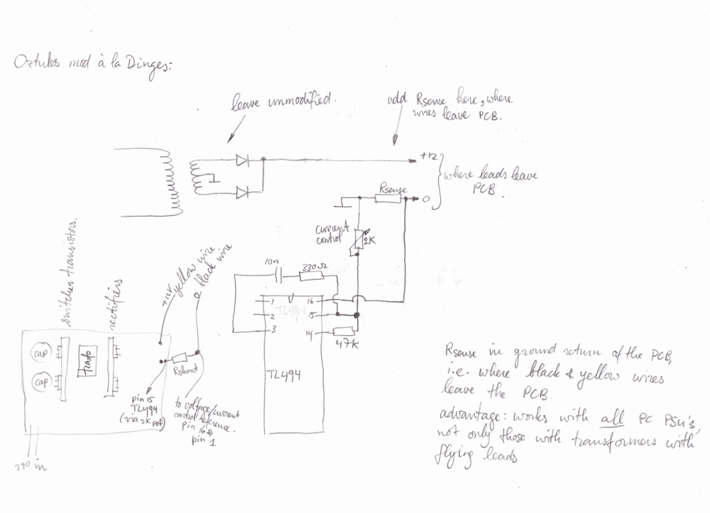

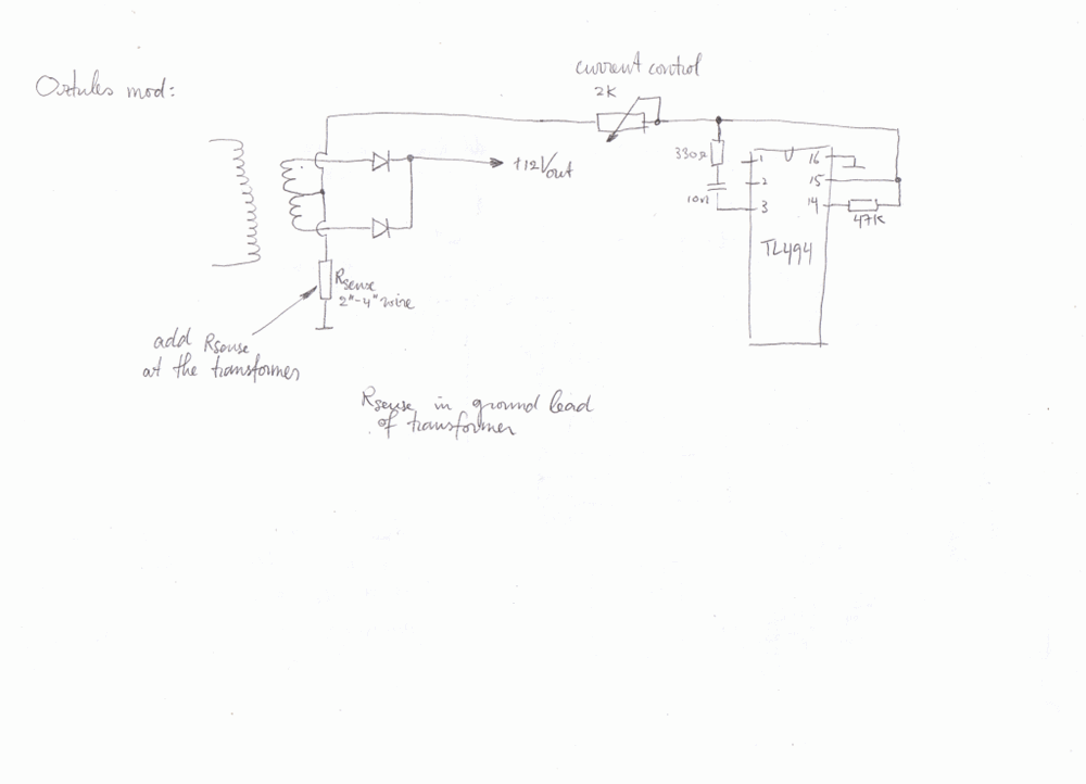

Have drawn a few schematics to make the difference more clear. And the advantage, if I may say so.
The original modification:
Peter's modification of the modification:
The difference is clear: the sense resistor is added in a different place. That's basically all there is to it, but it makes the difference between being able to (easily) convert all PC PSUs for current control, or only those with flying leads.

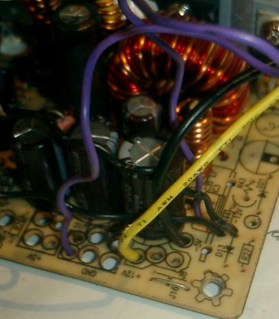

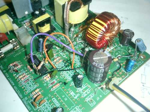

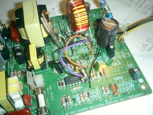

It's possible to install the new Rsense on the PCB, not leaving it floating - when the no longer needed components at the output are removed (+5, -5, -12V), several completely unconnected PCB traces will appear. These can be used to re-route the ground lead, add a shunt resistor (just a bit of wire) and connect the sense wire to the TL494.
In the picture, the purple wire is the sense resistor, which connects from the original ground point of the PCB to a free pad; to that free pad is also soldered the thick black ground wire that leaves the PCB, and the ground for the voltage control potmeter. That's all there is to it - but it allows 100% of PC PSUs to be converted (as long as they have an unused 2nd opamp in the TL494)
Peter.

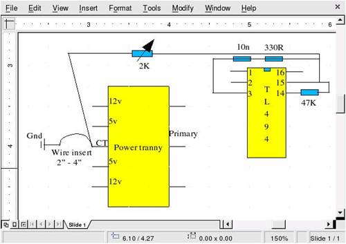

Hmmm, perhaps just isolate the track at the CT pins, and bridge the cut with your 4" of wire.. I might try that instead of lifting the flying lead out of the board... would look neater (not that it seems to bother animals such as myself).

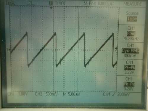

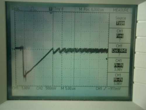

Managed to put the magic smoke back into the little PSU.
Turned out it was the TL494 that was defect. Below an image of the signal on the oscillator pin CT (pin 5) before replacement:
As can be seen, doesn't look healthy.
After exchanging the TL494 for another one the PSU works again, and this is how the oscillator signal looks now:
A few other things that changed about the PSU just by replacing TL494s, and which surprize me:

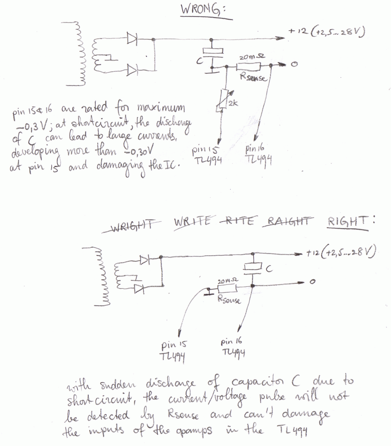

Finally, a circuit diagram to explain what I think went wrong with my implementation of Oztules' modification:
Above is an explanation of what I think caused the TL494 to go defect. In my modification, a short-circuit would discharge the capacitor and could easily draw a current spike of much more than 15A; this would develop more than -0.3V over the sense resistor, which could damage the inputs of the opamps of the TL494, which can't take more than -0.3V (abs.maximum rating).
This current/voltage spike was never an issue with Oztules' original modification, as the sense resistor won't see current spikes of the output capacitor. I haven't tried it yet, but placing the sense resistor in front of the output capacitor ought to solve this problem.

Edit: just ran a test, discharging an identical capacitor (560u/35V charged till 10.7V) over the original shunt resistor (19.6 milli-ohm). It results in a voltage developed over the shunt resistor of slightly over 1V, so a discharge current spike of 50A. Now, this was at 10.7V. At nearly 30V, that spike may be about 3 times as large, yielding a negative voltage of -3.0 V on the opamp inputs. Definitely far above its maximum rating.Edited by Dinges 2009-12-16

After replacing the TL494 I decided to do it properly, the Oztules' way.... removed the output transformer, unsoldered the two leads that went to the common-pin of the transformer, bent the leads up, added about 7cm of wire and a small sense wire (basically adding a flying lead to the transformer), added heatshrink to prevent shortcircuits and make it mechanically stronger, and resoldered it. And now it works - properly.
I can abuse it in every kind of way and it doesn't act up. Finally.

I'm not sure if my way is the "proper"way, but you have to admit it makes these things near indestructible.
