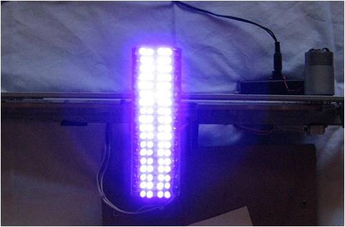

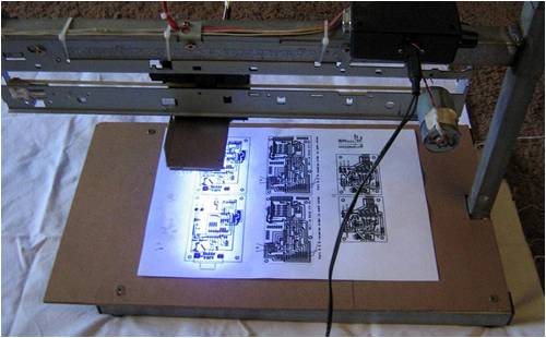

About 20 ultra bright UV leds ( from China ) supply the uv light and the leds chug up and back several passes over the print to expose it then switch off.
This is the second one of these scanners i built and this one i used uv led clusters instead of single leds as it worked out cheaper and was easier but either will work fine.
The first one had only 2 rows of leds and works just as well.
You can use sunlight or fluros at a close distance but they tend to be slow and give a lesser result (10-20 mins with fluros)

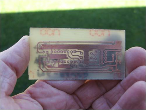

The photo shows a section of test board straight off KiCad - it's certainly useable.
One thing I have noticed with KiCad is the 'notches' it produces at the corners of the tracks on the printout - does anyone have a 'fix' for this?

The clusters i bought were 24 leds but i needed to take them apart and use in 8 led clusters or it allowed big gaps between the leds.
I would buy the single 8 led clusters next time.
The standard ultra bright uv leds (5mm singles) i used i dont remember the mcd ratting for, but it was high and more than likely from sureelectronics as well, i think they were AU$7.00 for a 100 or there abouts.
I have the leds about 100mm above the board for exposure.
with the leds stationary it takes about 30 seconds to expose through paper but travelling it takes a couple of minutes depending on the distance of travel required.
