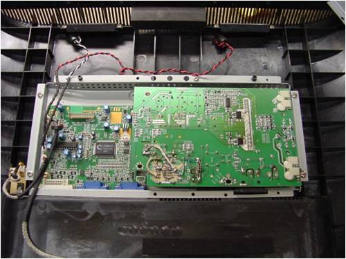

Popping off the screen and wiring harness to it, we find this...... the screen carries a mountain of very intricate whoop arse looking gear, and I ain't ever tackling that.

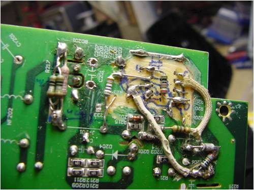

Actually, the bottom of one of those boards has been butchered, as this is after the ordeal, not before....

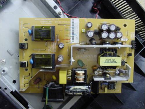

My heart sank, as I didn't recognize any of those little bits as normal stuff. I pulled off the top board, and cheered up some.... there was at least some through hole bits to look at:
You can see that there has been a fair amount of butchery there too... no before shots I'm afraid.
The black marks have been cleaned up some. The Fet was blown up, the fuse was blown, and ...... where was the PWM chip.....
The PWM chip was one of those cursed surface mount things...yes, on the hard to see side of the board and surprise surprise, 320v going through one of them just leaves a smudge and some leads and burnt plastic.

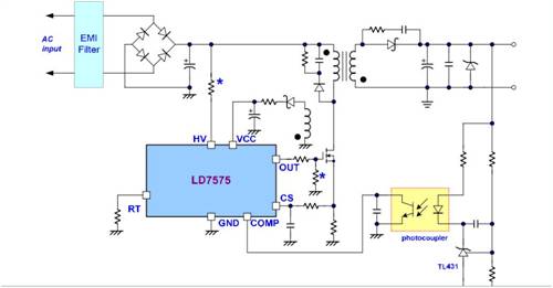

The second green pwm chip I researched was an ld7575... and it matched pin for pin. I was shattered, I couldn't track one down anywhere.... I needed a plan B.
Looking at the data sheet for the 7575, we find a typical simple flyback circuit looks like this :

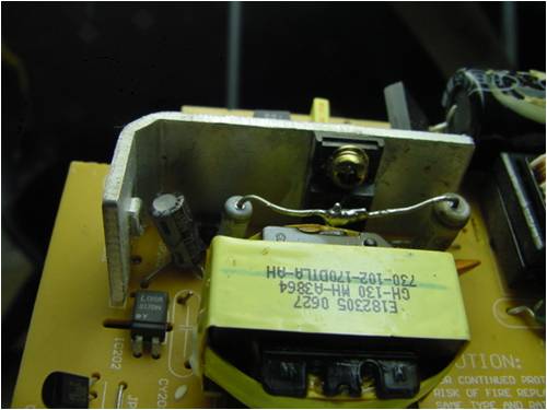

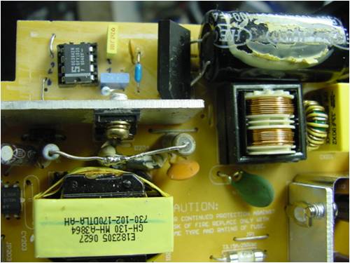

I grabbed the trusty 3842's out of the box, and proceeded to graft it onto the board... this was the tricky bit. Their entire PWM was built on the surface mount side, and 20 odd components used less room than a postage stamp.... what to do.
The big smoothing capacitor took up a lot of real estate on the top side of the board, so I resolved to use this space, and put the capacitor elsewhere.... anywhere..and a few (what I felt) unnecessary compoments were turfed out all together.
It now looks like this
You can see the capacitor was prized off the board and repositioned (where some other stuff used to be), the bridge was moved back a bit, and the 3842 through holed into a socket... (not very confident are we??). A few more holes and a few bridging wires, and we have half of it built. On the other side it looks just as woeful:
I scratched all the surface mount stuff off the board with a razor blade, and scratched all the tracks off as well. With some filthy soldering and slapping the bits on, I was finished. I replaced the Fet from out of a computer monitor from the tip, and last but not least, I wired up a rudimentry bootstrap circuit (80k resistor and 18v zener)......The bootstrap is the two messy looking resistors between the transformer and the fet.
After this, the tertiary should take over..... and it didn't. The 3842 I had (gotten cheaply from Rockby) didn't turn on until 16v... and the tertiary winding was only 12v...dammit... 16v wins, and the tertiary doesn't get a look in.
I'll worry about that later, the bootstrap will carry it until we find out if the rest of the thing works.

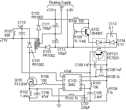

It was modeled around this circuit here:
Obviously were running it at 320v not 17v... but close enough...
Well it was time for the quick check around the board to see if all was well..
3 electro's were down from 1000uf to about 50uf. This is what appears to have o/loaded the fet which then blew everything up.replaced these and moved on to the 2000v screen supply PWM.
At least this although surface mount, used a surface mount tl494... home territory. I used a 14v supply to mimic it's input voltage. The oscilloscope showed the oscillator was functional, and by driving the dead time pin down, the 2000v hissed into life for a few seconds. I tracked down who was turning me off, and bypassed that (the computer on the other board controls this chip for brightness, sleep etc.)... satisfied with this.... it was time to switch on.... and I was greeted with this.....

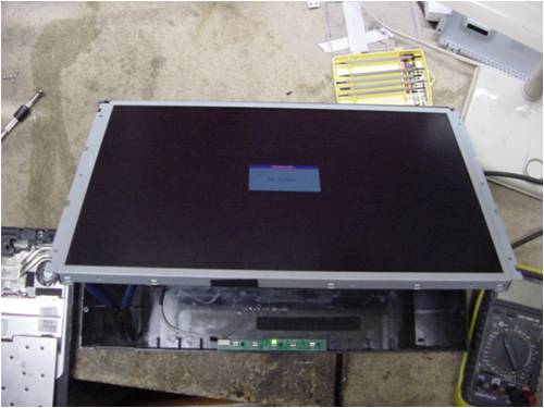

Feeling pretty smart about now.... and then it went blank...panic sets in, I go over it all , and all seems fine. Switch it on, and it works and stops again.
These smart damn machines, I had forgotten to give it some video drive, so it switched itself off after 20 seconds.... nothing wrong at all perhaps.

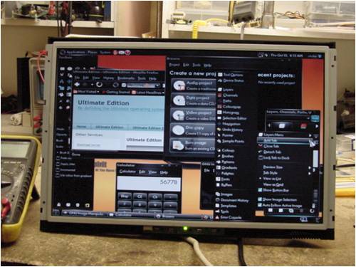

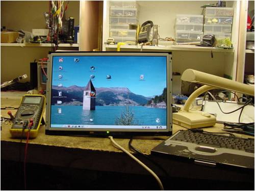

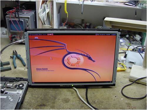

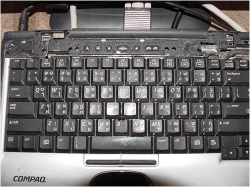

I had found an old laptop at the tip....
After fixing it up (idle Fet), and tossing aside the screen/lid, and cleaning it up, loaded up some software (Linux Ultimate2) and tried again.... this time it was all different.
and for more complex stuff like this:
So, there is hope for those Neanderthals out there, who like me rue the passing of valves, and then sort of rue the passing of transistors.... and are less than impressed about the surface mount stuff.... if you stick to your guns, and smash out some extra space... we can still fix somethings.

I only now realized something: that big glob of adhesive on the electrolytic capacitor..... Looking at the board, I don't see anything else to which they could've bonded that capacitor than to the heatsink of the switcher FET. Please, *please* tell me that they didn't do that....
If there's one thing electrolytic capacitors can't stand it's heat. Expected life of an electrolytic cap decreases very rapidly with relatively small increase of temperature. Providing a thermal bridge between such a capacitor and a warm (hot?) heatsink would not be a very smart thing to do.
Peter.
Edit: dumb of me - that's the replacement capacitor, not the defect one. Scratch previous remark.Edited by Dinges 2009-10-19

That is the original cap. It was glued to the board. It is only a filter cap on the HV side..... but I needed it's space ... so flipped it.
The failed ones were on th LV side. (25v not 320v).
1000uf@320v would be a touch bigger me thinks..
.........oztules
