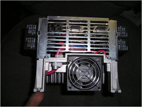

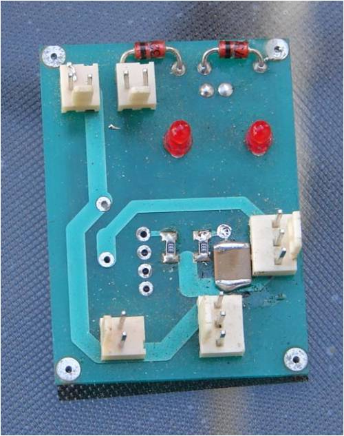

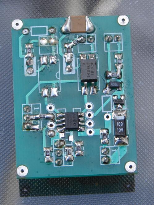

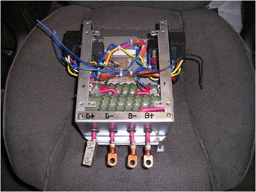

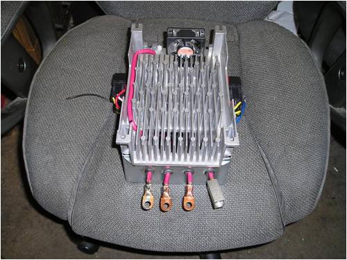

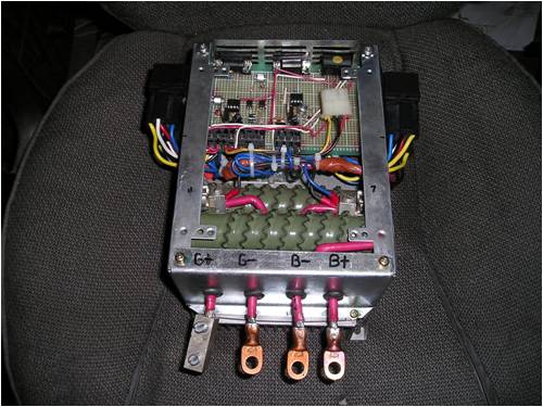

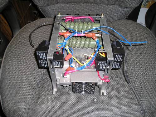

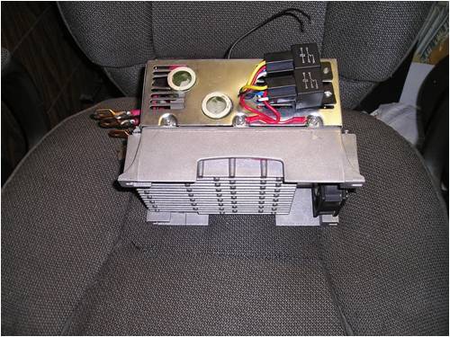

First i want to thank glen and anyone else who came up with the piclog.
I have just finished building mine with a few changes,
basically two piclogs on one board with diode turn around at coil curcuit.
1 piclog charger only and on same board 1 that will record all data only.
Also had to change PicAxe_1.2_Ver2 Logging program,
(Count 5, 1000, WSpeed )TO (Count 2, 1000, WSpeed)so i could get all data RPMs And WSpeed.
I also added in two phone jacks for the rpm and wspeed wiring.
now i can record data.
instead of video tapeing
YouTube Vid Edited by windman1000 2009-09-04

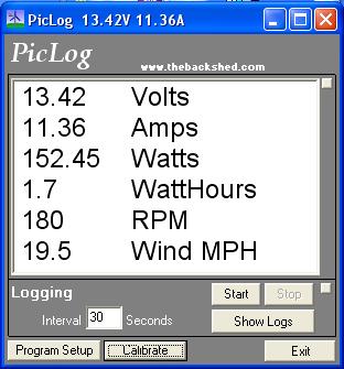

Posted: 12:15am 04 Sep 2009
Had a little wind for a very short time today and was able to get a screen shot.
This Is mounted of the hitch of my truck while im doing blade testing.and no im not driving it around.
Posts: 5190
Posted: 12:31am 04 Sep 2009
Thats a pretty good result there Windman, be interesting to see how it goes when you get some more wind.
The Piclog build is very well put together, looks cool.

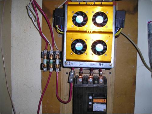

If I made just the Piclog Board for you could you put the rest of it together?
The rest of it would be Box , Shunt ,Relays , Wireing , Fine tuning Picaxe Software.
My was Made for a DC Generator but thats was only a blocking diode insted of a rectifier.
And im 12 volts, If you wanted 24 volts I counldnt fully test board.Edited by windman1000 2009-09-15

hi jim
i only have one more of those boxes with massive heat sink on it, and i need it for a nother piclogger.
as for the shunt resitors and relays i have no more at this time and im not to sure how to make this piclogger to work on a 48 volts system but im sure it can be done with no problems, as for the picaxe software all adjustments are easy to do by just asking here what you wanted to adjust.

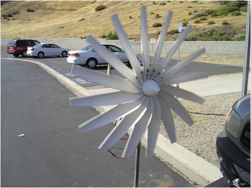

i think il have my new wind generator and 16 pvc pipe blades up tomorrow, 16 blades for low wind high torque.
and as soon as its up i know there will be no more wind

16 blades! now thats something that I am sure most of us would like to see? In case you did not know the newer PVC blades are awesome.

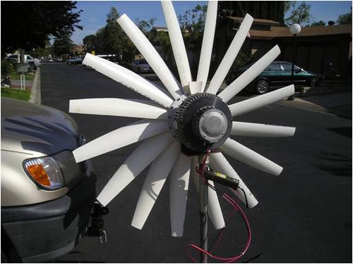

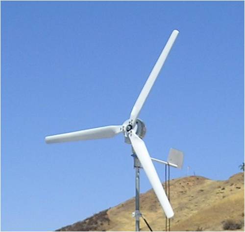

I did get my up today and while I was re running 0/2 wire from wind generator and the wires for rpm and wind speed , i could see the gen turning aprox 120-160 rpms in a nice low breeze.
But as soon As I Was Ready To Record, The Wind Went Away.
Il get pictures of the gen up in place this week , But here is the 16 Blade on a test stand With gen im running.
Edited by windman1000 2009-09-22

You could call it the Windman1000. I can't help but to wonder what the neighbors are thinking? (a cooling fan)

My neighbors Call it the wind stopper, every time i put up a multi blade the wind seems to go away and its a waiting period.
