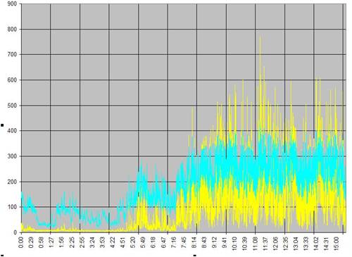

Posted: 06:28am 03 Sep 2009
From the lack of informed responses to this question I will provide some good reasons why mechanical switching of a dynamic windmill system is likely to end with failure of mechanical components. You really have to ask ?? Is there a successful commercial implimentation of star delta switching?
Here is a graph of a typical windmill output in a 15hour operation window. There was about half the time with low winds, and the other half was variable/reasonable winds.
rotor RPM is the teal coloured graph, and output power is the yellow graph.
There were many wind gusts during this recording window. There are approximately 2000 RPM transitions through a set point of 180rpm.
Now, if I had a relay, star/delta switching system, it would be required to change the windmill wiring configuration 2000 times.
I will let the readers think about this a bit, and it will be obvious why I have chosen a switchless arrangement to achieve the optimum loading on my windmills.
Gordon.

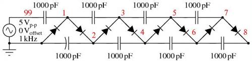

GWatPE
Joined: 01/09/2006
Posts: 2127
Posted: 01:39am 05 Sep 2009
Hi AMACK,
the charge pump cct you posted above is not suitable for a windmill. The series arrangement of components is the giveaway.
My 3phase parallel setup, linked to in my post above, has low impedance to deliver amps, not mA.
Gordon.

Dinges
Joined: 04/01/2008
Location: Albania
Posts: 510
Posted: 02:43am 05 Sep 2009
[quote=Gordon]There were many wind gusts during this recording window. There are approximately 2000 RPM transitions through a set point of 180rpm.
Now, if I had a relay, star/delta switching system, it would be required to change the windmill wiring configuration 2000 times.[/quote]
It depends on the integration time you use for switching, and the amount of hysteresis you'd set it up with. If you have a simple algorithm that directly switches from star to delta at 180.0 RPM, and back again at the same threshold, then the relais will do a lot of switching. If however you integrate over a, say, one-minute period and switch once a minute, then that would seriously reduce the amount of switching.
If you then also add a bit of hysteresis so the relais won't chatter (as RPM will likely drop again in delta, due to lower impedance and thus higher loading/more delivered watts -> lower RPM -> switching back to star), that should greatly help in reducing the wear on the relais.
Solid-state relais would be another solution to overcome the problems of mechanical relais.
Mechanical relais have been used in industry for control purposes for over a hundred years. Machines with hundreds of relais work reliably for many years. So, I see no reason why the same relais couldn't be used for wind too - provided one uses them sensibly, i.e. with an integration period and hysteresis.
About the circuit AMACK showed - I agree with what Gordon said. The circuit AMACK mentions is a Cockroft-Walton multiplier. It's a simple and cheap way of generating very high voltages (I played around with them in the past and got up to 100 kV (estimated) using 3 multipliers from a colour TV) but only at small currents (less than a mA). Ideal to generate 25kV for a CRT in a TV set, or the high-voltage for a X-ray tube (ah... the foolishness of youth - good thing I didn't have internet back then, or I'd have probably succeeded in building and operating a X-ray machine; a few months ago I finally said goodbye to that part of my youth by throwing away the valves that would have been useful in such experiments. My offspring will thank me for that.... )
The circuit is not useful to increase the voltage of a windturbine though.
You could check out boost converters too to increase the voltage. If you google around for this term, you should find plenty of circuits. I'm not a fan of them myself, but if you really feel like you have to increase output voltage this way (and not the 'correct' way by rewinding the alternator) then you could give it a try.
Peter.Edited by Dinges 2009-09-06
