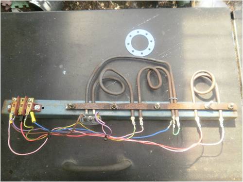

I'm working on a dump load for a new article on the main web site. I don't know how well its going to work yet. I'm using 50watt 12v bulbs, which I bought for 25 cents each! Cheap enough. I've mounted 6 in a old PC power supply case, with fan, to give a 300 watt dump load. Light bulbs are not the best form of dump load, they have a high inrush current, but these are so cheap it's worth a try. I fear the bulbs will get dust on them and blow from hot spots, will see how it goes.
In the past I've used heater elements from electric jugs. I had to unwind the heater element, cut into 4 lengths and re-wind it on the former to get the resistance low enough.

All I did for my dumpload was trip the nichrome wire off an old 240 volt water heating element and wound it over 2 bussbars to get the ohms down. For the fets I used a pair of 169 amp one from jaycar and its worked a dream ever since i put it in.

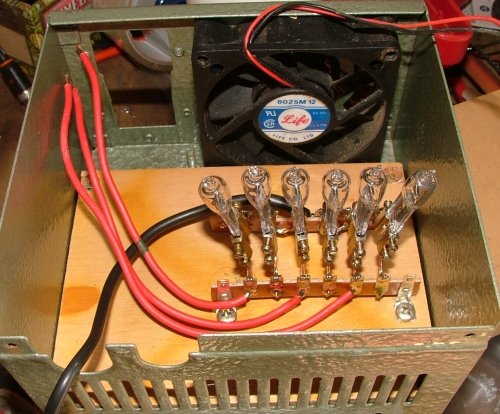

Gizmo (Glenn )
Have you thought of using quarts down lights, they are not effected by dust spots and are cheap. The only down side is there size. I use them on my dump and they work well. They come in a 55 watt size and bigger I think too.

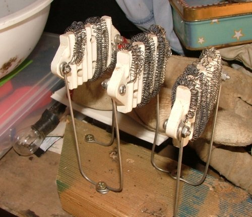

Edit: went back and fleshed it out a Bit Tinker... does it make sense now??Edited by oztules 2009-08-14
Posts: 5200
Posted: 11:06pm 12 Aug 2009
"then just 1 will do.... we unwind all the wire, and divide it into 9 lengths (for the old 1000w @ 110v type about 12 ohms), and wind 9 "mini" radiators... each of 1.3R. Each should drop about 9A... giving you about 81A @ 12v"
Is that what you were looking for?
oztules
Joined: 26/07/2007
Posts: 1686
Posted: 02:27am 13 Aug 2009
Yes that looks like the original waffle Gizmo... I must have zapped it somehow when I edited/added info for Macgyver.

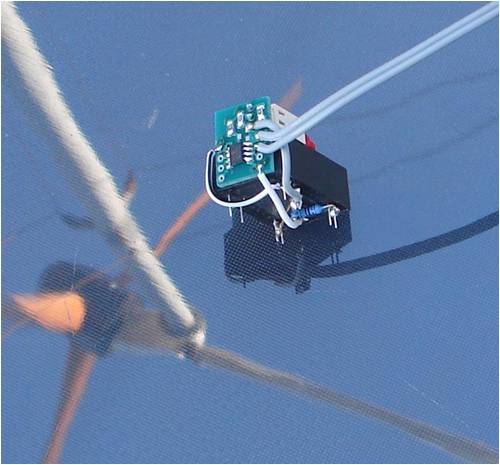

Posted: 07:02am 13 Aug 2009
Here is a photo of the controller I put together for my new AxFx 48V alternator. This windmill is the mother of a design that fillm has posted pics of.
The unit just connects to a suitable mosfet. This one stops the windmill when the battery voltage exceeds 60V, and allows normal operation if the voltage has fallen back to 56V and the windmill has been turned OFF for at least 5 seconds. The micro PCB is stuck to the end of a nom 48VDC-reg5VDC converter. The scaling resistors are pretty simple. I have solar connected to these batteries as well and the gridfeed inverter is the nominated proportional loading, so a separate heater bank is not required.

Posted: 09:48am 25 Aug 2009
Good to see you went with the idear of down lights. I use them in my set up and they work well. I have seen a mention in a forum topic that said they where going to use them but there were concerned that if one blew the drop in load may damage there battery bank. I think that if one blew then the effect on the batterys would be quite small unless the bank was small and the globe was not detected for some time. Is it possible to find or disign a circuit that would dump to another dump as a fall back system to protect the battery just incase or is this just over the top.
