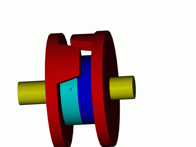

Another solution would be to install one big, round magnet (with hole in it so the shaft would fit through); see sketch below. I've only drawn two pole fingers for clarity. The red rotor plates will guide the magnetic field to the fingers, which in turn will project it to the stator. Just as in the original situation, except now we're using a permanent magnet as opposed to an electromagnet:
The downside is that some (much?) of the flux will be shorted by the shaft. If you'd not want that, you'd have to machine a new shaft out of a non-magnetic material as for example (austenitic) stainless steel. You'd also need to find a suitably sized magnet (shouldn't be too hard, given the enormous choice in dimensions for magnets that are nowadays available)
