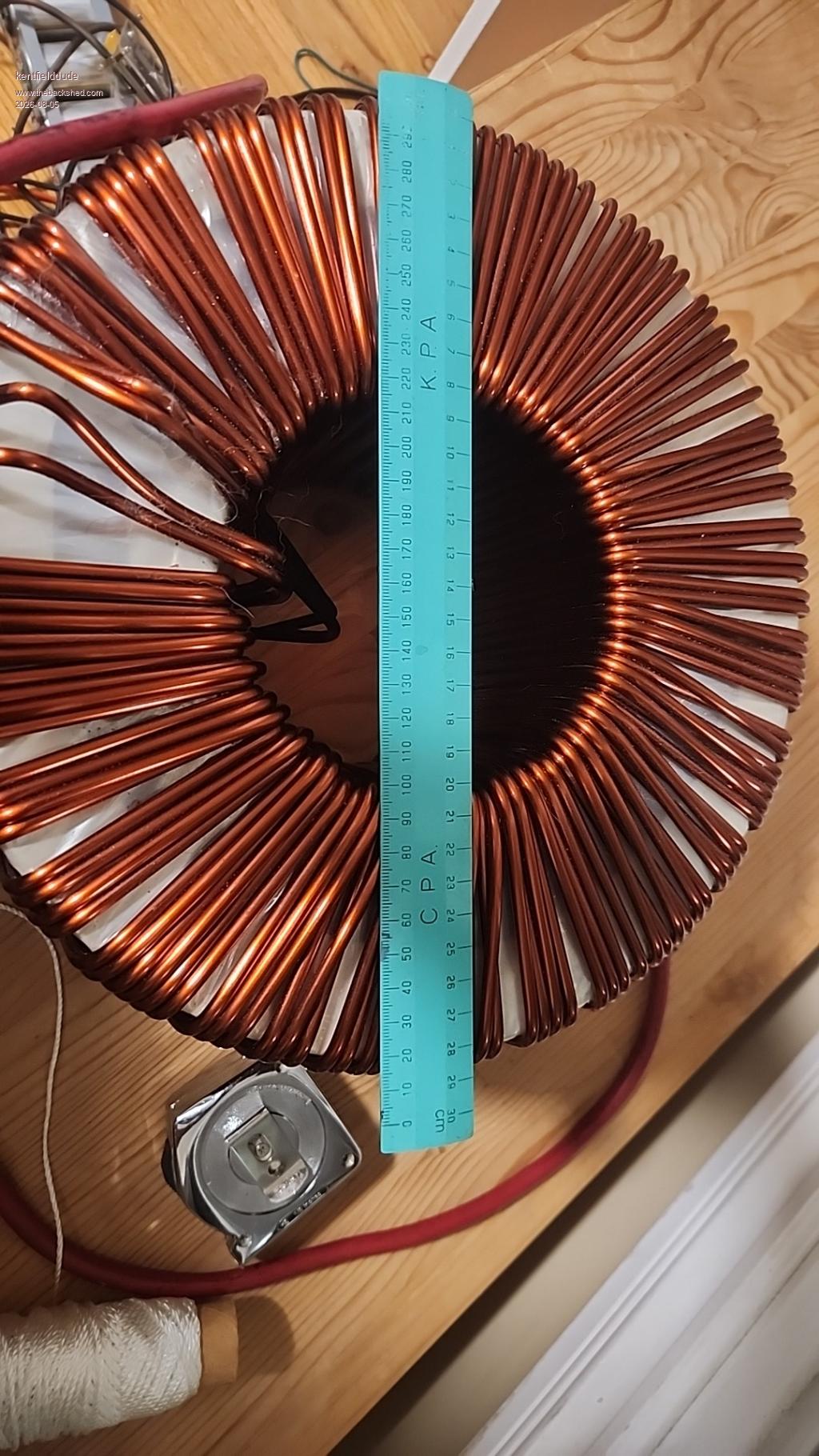

I'm trying to figure out what I need to finish the primary winding and prepare the core for the secondary.
The enameled wire got some small nicks in the enamel on the outside windings. What's the best red insulating varnish to use to repair it?
What type of mylar should I buy?
What's the best way to connect my two split windings together?

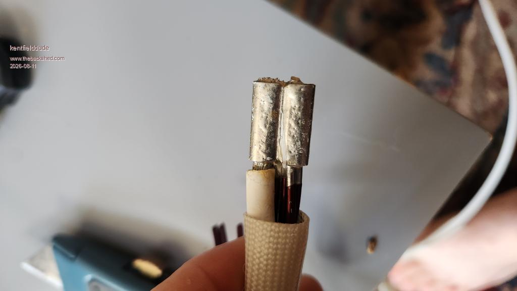

Posted: 12:01am 11 Aug 2026
What is this type of connector called?
Pete Locke
Joined: 26/06/2013
Posts: 186
Posted: 07:50pm 11 Aug 2026

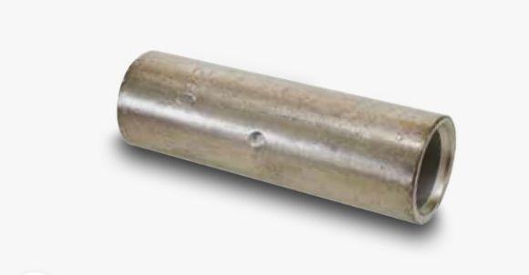

That looks to be a 'Crimp Link' connector that has been cut in half.
Used for joining mains cable together, but also very good for providing a hard connection point for stranded cable.
Available in a range of sizes from any electrical wholesaler of the usual on line suspects.
