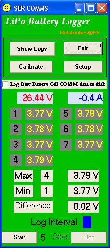

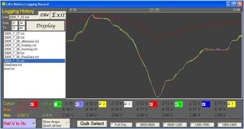

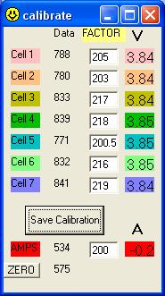

Here are some screen shots of the calibration screen and the main logging window and an example graph.
I now have a pretty good handle on VBcoding, and this makes the behind the scenes task a bit easier.
To expand the system more than 28 channels will require use of the scratchpad area of the picaxe. My first attempt to use this was not a great success. The X2 chips only have 28 GP word registers, and this limits normal data transfers. May have to look at this a bit more.
I was able to simplify the "file to graph" selection window. As long as the files are in a subfolder called logs, and contain valid data, they can be graphed, by just clicking.

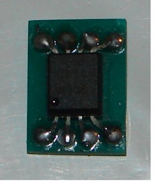

I have made a small picaxe 08M module that has a programming port. This can be easily added as a daughter module to a bigger project. All that is needed is the opto coupler and some external scaling resistors, or headers for Alegro type current sensors. My picaxe 28X2 is now only a serial data multiplexer with some simple calcs for ensuring valid data, and the data string generator for the computer transfers. I will be looking at a version with a larger dedicated LCD with a logging output option as well.

I now have some optically isolated linear amplifiers.
This is one. They are SMD devices, so this one I have soldered to a small pcb for testing. The part number is ACPL-C784-0D0E. These are an 8pin device. + & - 5V with differential inputs, with optically coupled output.
I have also been able to configure normal opto couplers to give a linear voltage transfer. These require a gain and offset calibration, but at least the transfer function is linear. I will be able to have isolated measurement of voltage, with the outputs able to be referenced to the micro ADC directly.
The use of these components will increase the resolution. I hope to achieve 2-3mV resolution for voltage, and 50mA resolution for current on my LiPo battery test rig. The current measurement will require an isolated 5V power supply, but voltage will need <1mA from the voltage source being measured.
I intend to reduce the loggers from 5 to 3, by combining functions. This will simplify the applications needed to control the data storage.
