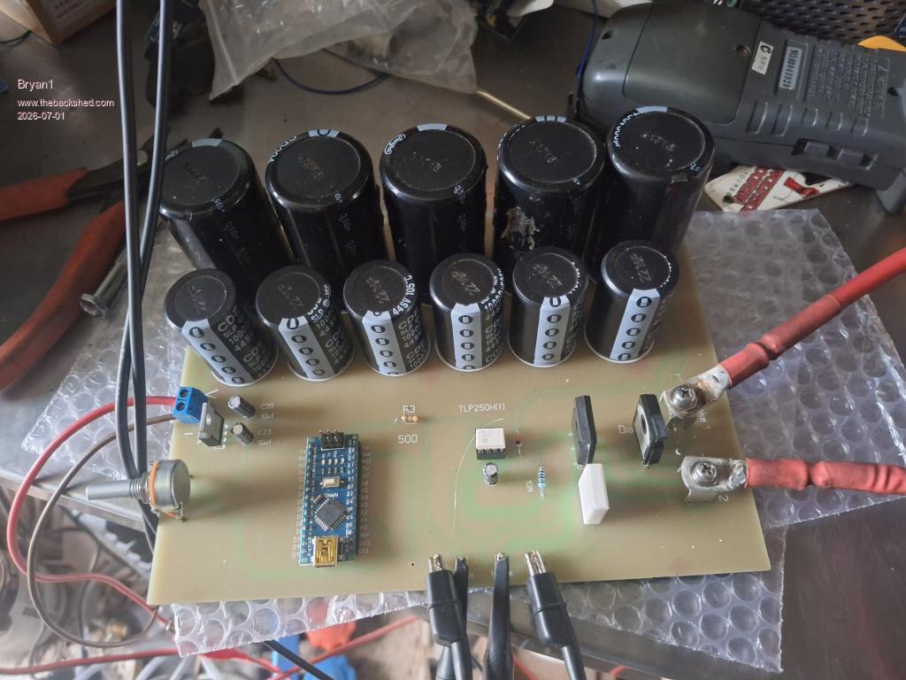

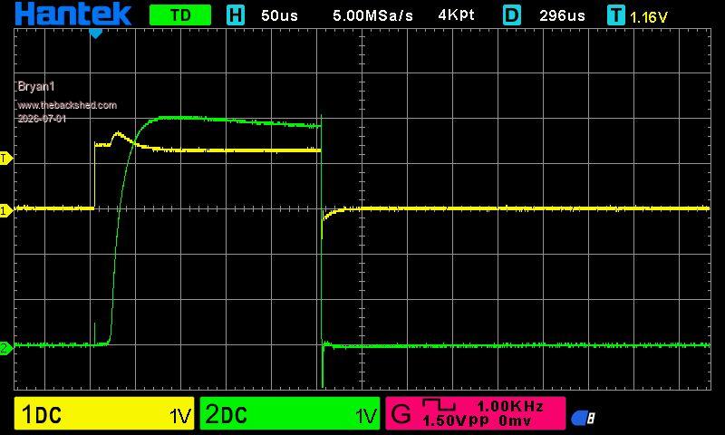

           Well this thread is for my trials testing out Poida's Induction Tester where I designed a PCB and got it working off the first draft
Now the board has 62,800uf worth of capacitors using 6 off 25 volt 10,000uf and 5 off of the 560uf capacitors off the aerosharp board. Now as I am still learning PCB design with Sprint Layout larger holes were needed as I only did 1.5mm holes. A 1.7mm drill was used to open up the holes so the larger components would go in.
The 5K pot I used was a smaller size so to get it too fit I just soldered on some legs off a TO-247 old chip to each pot contact. Now the dual diode is also a TO-247 and I only put a 220 chip spacing so just bending the outer legs got it fitting nicely.

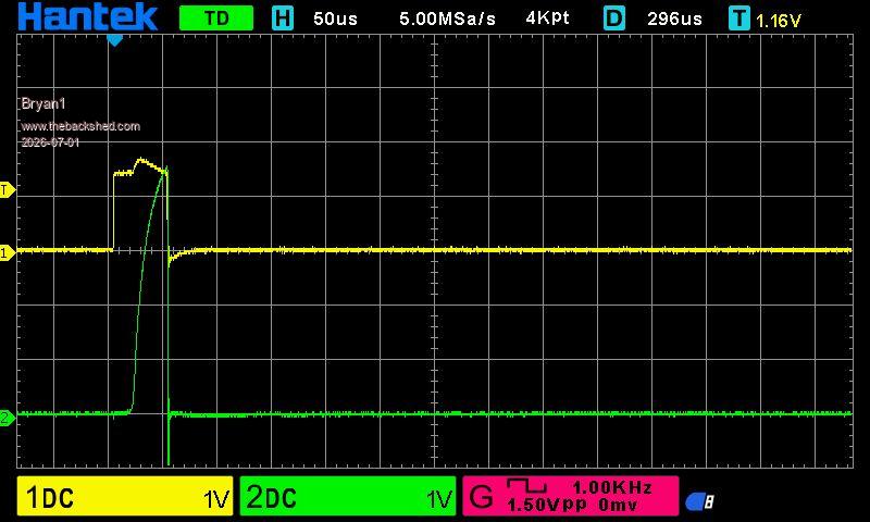

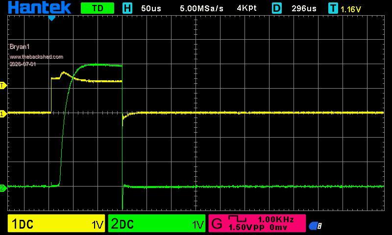

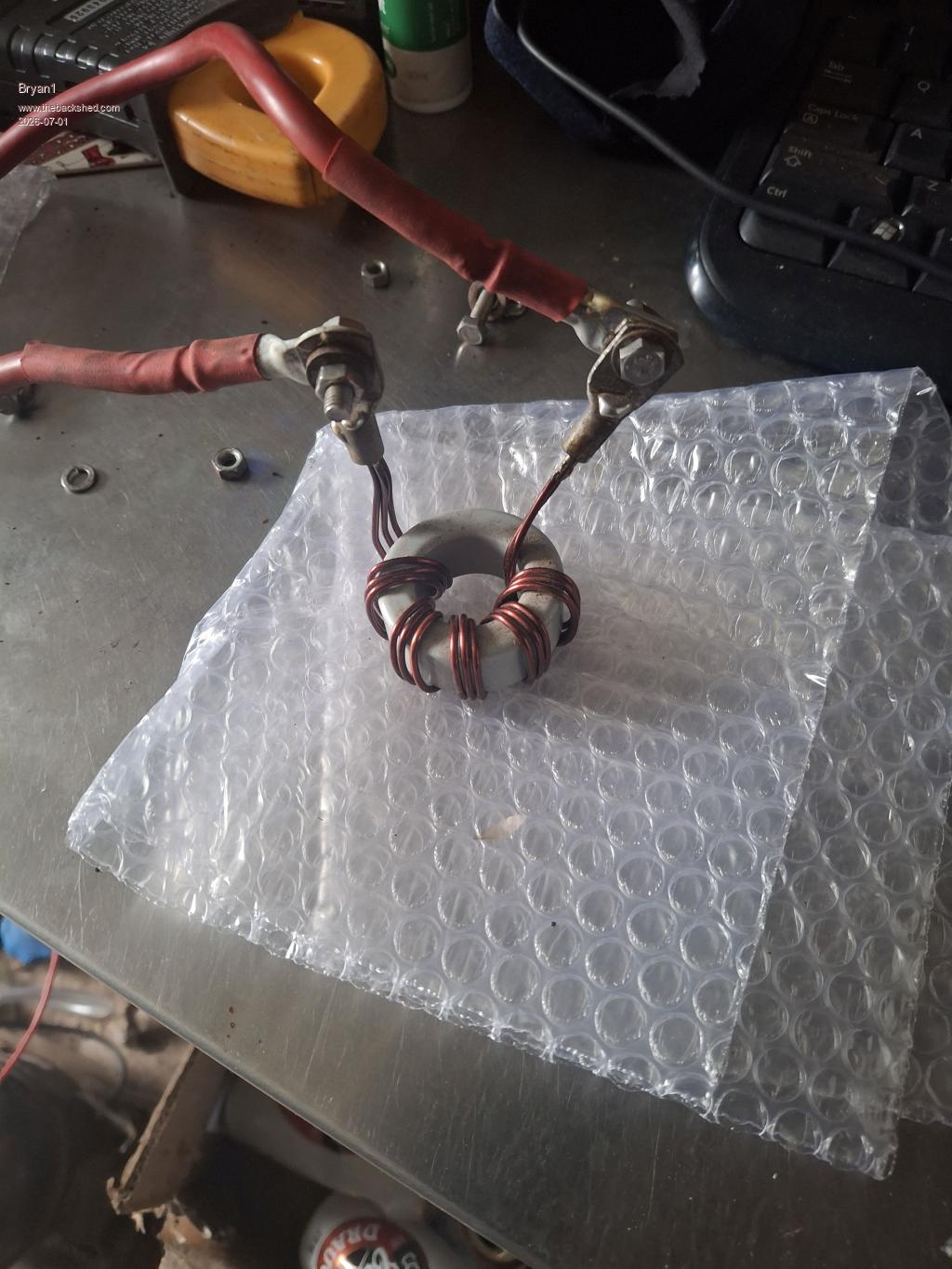

I made a couple of inductors using a single 42mm diameter grey toroid with a 24mm hole and 17mm thick. I put 3 inhand 1.6mm wire with 5 turns, now my in DMM induction tester show .320mf the induction tester does show the true uf value with is very low.

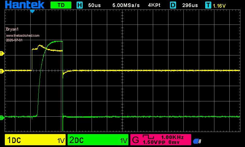

Now I have been using the 100us timebase so with Phill's suggestion I shortened the timebase to 50us and went with shorter pulses.
50us
100us
150us
250us
Now after 350us the sense pulse breaks down.
So overall I am happy this induction tester is working and I do have 4 spare boards if members want any.
Regards Bryan

If that small toroid is high frequency material, the inductance would be tiny and it would likely saturate with just a few Amperes, it just looks like a complete saturation curve, or something is not quite right in the high current paths between the caps FET and choke?
Of course, I could be totally wrong

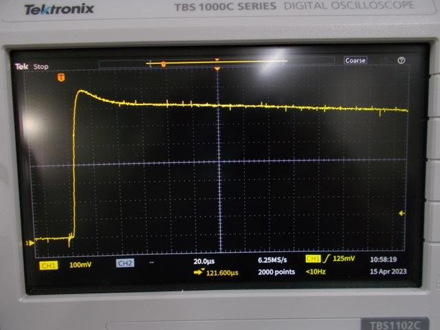

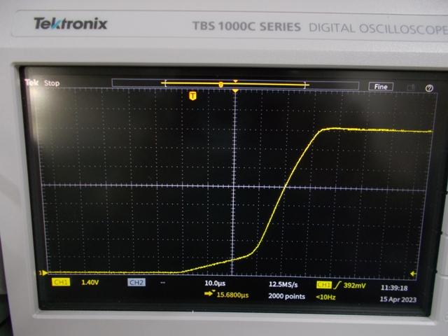

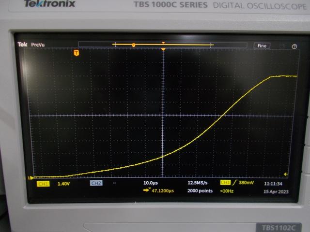

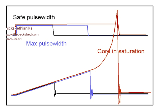

It would be nice to see the cap voltage instead of the yellow, gate pulse? Like someone else allready said the cap voltage is probably sagging or close to zero, normally the current (green) should skyrock thrue the roof instead of being constant or bending to the right. Allthough the tester is doing what it's supose to do it lacks capacitance to sustain high current with limited voltage sag, you need to zoom in a lot to make sense of the curve, like 1-5us? Soon as your cap voltage sags to much the inductance you want to calculate based on di/dt is not true anymore, you need a constant (or close) voltage in the caps to have an accurate measurement.
Best way to maximize the potential of the caps is to use as high voltage as they can handle and use smaller pulsewidth.
Edited 2026-07-01 17:21 by nickskethisniks
poida
Joined: 02/02/2017
Posts: 1497
Posted: 08:17am 01 Jul 2026
Nicks, that is an excellent illustration.

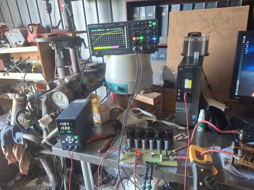

Ok inbetween rain storms my net connection is playing havoc so setup the aero-sharp choke and increased the voltage to 16 volts.
The current draw on choke is my clamp meter also Voltage and current are the read outs from my power supply.
Pulse   current draw on choke    Voltage   Current
100us       1.3 amp                16       80mA
150us       1.8 amp                16      173mA
200us       2.2 amp                16      295mA
250us       2.5 amp                16      400mA
300us       2.9 amp                16      520mA
350us       3.1 amp                16      670mA
400us       3.6 amp                16      780mA
450us       3.6 amp                16      955mA
500us       3.7 amp                16     1.07A
Now on my first go I was topping out the 900mA limit I set so increased the current limit and the above figures did confirm
So took a pic of the setup where it has taken the full screen and still no signs of this breaking down.
Now just had to go that bit further   and we finally got a voltage drop on the power supply, the current on the clamp meter was 4.1 amps.
Regards Bryan
KeepIS
Joined: 13/10/2014
Posts: 2284
Posted: 03:27am 02 Jul 2026
Unfortunately the current clamp meter is not fast enough to read anything meaningful with an xxus pulse, the same with the Power supply, and especially if the supply is sitting across the large value of Capacitance on the Sat-tester board.

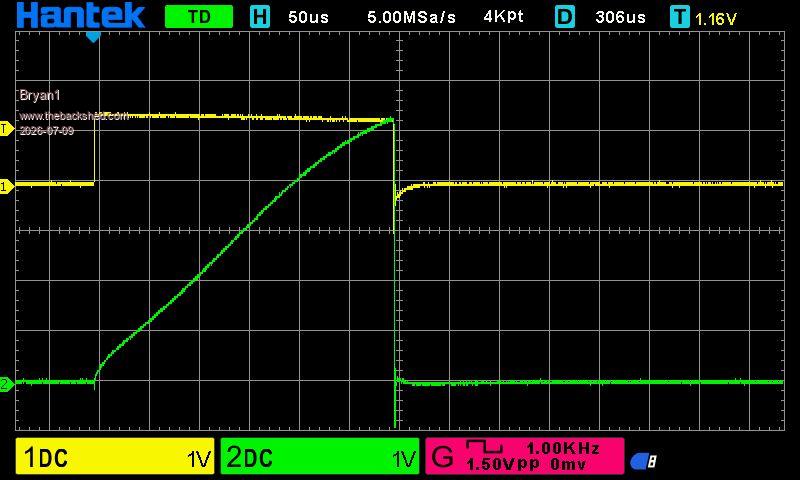

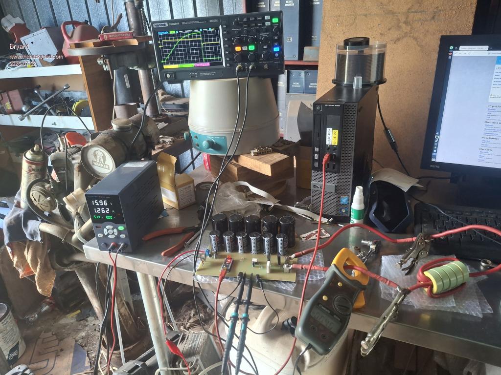

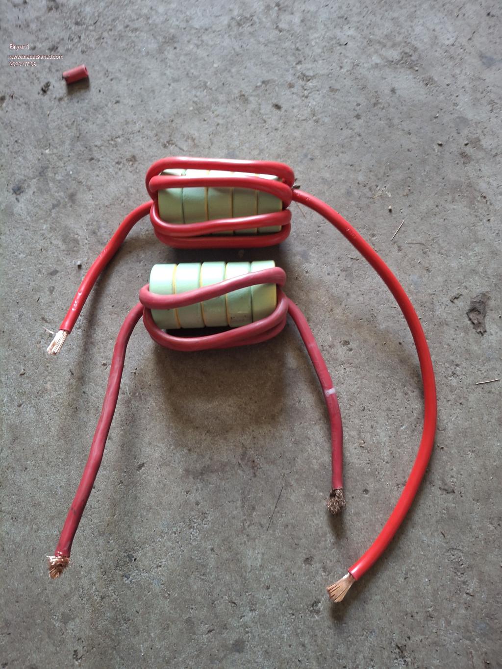

Ok I had a bit of look at these 40mm green toroids with a yellow top and the AI on google said it's more than likely it a T-26 powered iron core suited for chokes among other things
So glued 5 of them together as I do have 10 of them so a pair can be made and put 5 turns of 7mm diameter wire thru.
Now the current ramping up on each adjustment of the pulse it's not in my opinion going into saturation as the sense is still rising now going a wider pulse does make the sense trace drop off so one would think thats is the saturation point.

Well looking at the scope figures for the T 26 iron core trial
6.8 volts rise on the sense trace is
6.8/0.02 = 340 amps
Now for the inductance
15.96 x 0.0005/340 = 23.47uh

All good Nick   this is a learning curve for me so all information is welcome, now with testing the big aero-sharp choke Poida did do the test on the one he had and got the same result.
Now with that T 26 powdered Iron Core the sense trace was less curved and alot higher when doing the uS steps and comparing the 2 tests the T 26 won hands down where in fact it did go longer on the us pulse before breaking down.
Ok from a newbie's perspective the capacitor voltage will be the same as the supply voltage wouldn't it as feeding DC into the capacitor is tied to the voltage. Or with this tester is my idea all wrong.

I must admit since I have got that Induction Tester finished and working I'm very happy with what I'm seeing with the inductors I have made and seen the one I made this morning out perform my aero-sharp one
So the mornings job is stripping the wire off those last 5 green toroids gluing them together and then the hunt in my wire pile to find more 7mm diameter cable to make the second choke.

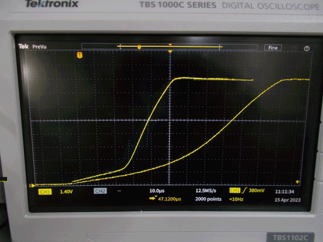

Ferrite E-core and Sendust toroid core saturation curves.
Yellow Trace: Isolated 500A Hall effect Current Sensor output, rated to 700A but peaks around 1200A with good accuracy.
Tested against a High current resistive Shunt - to over 1000A and virtually identical, but without any noise.
Test voltage 100V.
Vert div = 175A per division.
No shunt Resistor, using the high current Hall effect sensor above.
For reference, a 1-ohm resistor in place of the choke - 1400A.
16uH Ferrite E-core choke, gaped and 4 turns:
37uH 10 stack toroid test choke
Quick overlay of the two chokes curves above, see the abrupt saturation point of the gaped E-Core at just above 175A.
Keep in mind that the E-Core started with less than half of the inductance of the large test stacked toroid ring core.
Edited 2026-07-03 18:34 by KeepIS
