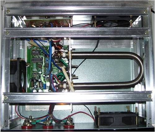

Hey I'm wondering if anyone can shed some light on the operation of those cheap Chinese windmill ( the ones with the noisy fibreglass blades ) controllers. I know the controller is pretty unreliable and dont last very long, but I was wondering how they regulate the output. Is it a shunt controller? If anyone has a pic of the cct board that would help.

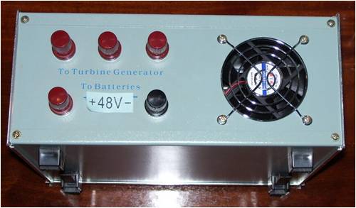

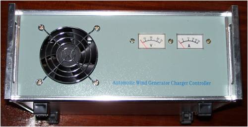

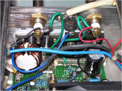

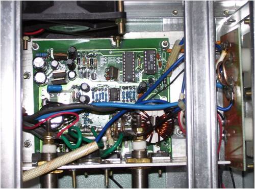

I have one here, never used, from my 1KW machine Glenn.
I'll see if I can remember where I threw it and take some pics for you
RossW
Joined: 25/02/2006
Posts: 495
Posted: 08:17am 03 Jul 2009
ok, lousy shots, sorry, but here goes. If you want more detail, let me know and I'll try to take some better shots when I have better light....

Thanks for the photos Ross.
I've got one of those circuit boards, minus the bridge rectifier. I think Dennis gave it to me, it was broken. I didn't know it was used for.
The dump resistor is 3 ohms. There's a micro chip, MOSFET driver ic, an awlfull lot of parts for a simple controller.
