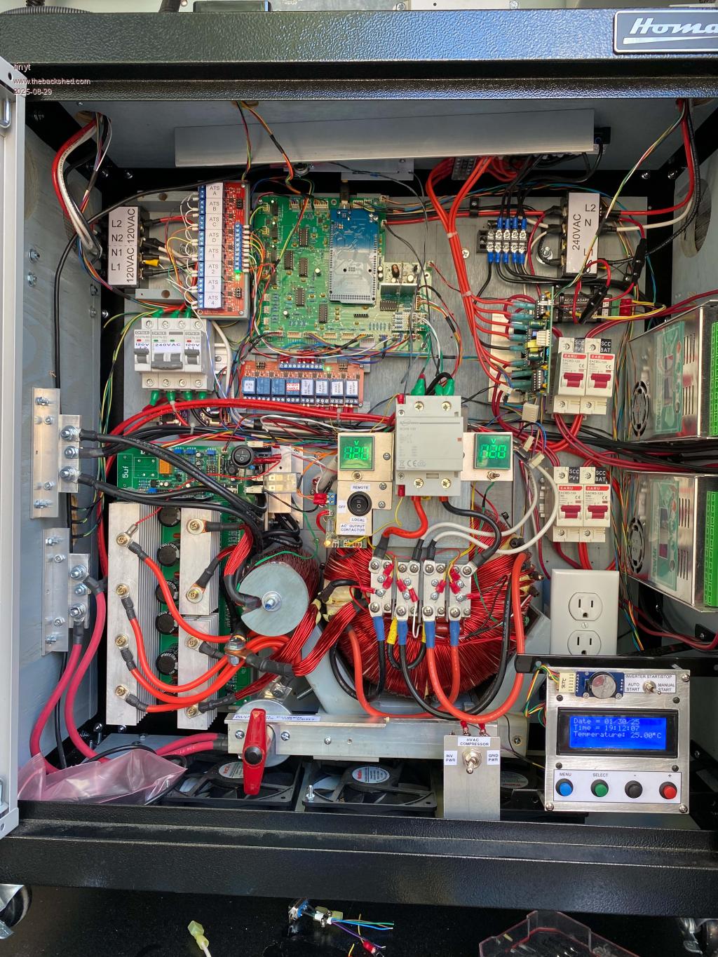

I made 3 of these using modified chinese inverter power boards.
Two are currently working at each of my two son's house, powering half of their household loads. During install, we tested succesfully start-up of their HVAC compressors. But it was not part of the household load.

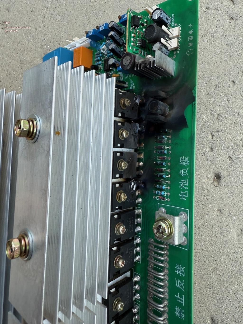

Last week, one of my sons connected the HVAC compressor to the inverter and BOOM! - I have now joined the elite club of mosfet destroyers.
Edit: Picture was taken after loosening the mosfet mounting screws.

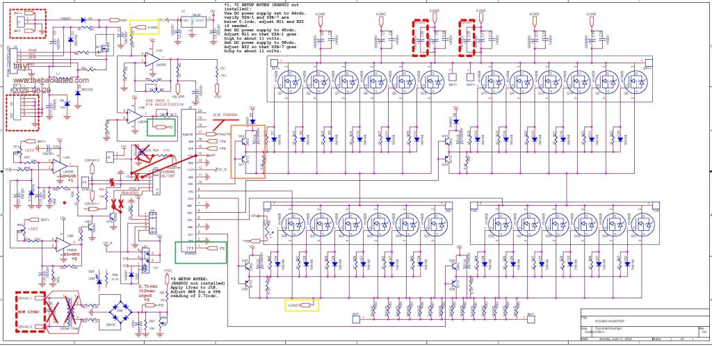

In addition to adding a soft-start modification to the compressor wiring, I am now attempting to adapt Wiseguy's robust mosfet driver design to the chinese inverter power board.
Opto Inverter.pdf
I hope I will not make mistakes. Now waiting for ordered parts while I figure out how to install and connect them.

 I don't have proof but I suspect negative drive bias voltage on the upper and lower FET's would be more helpful than opto interlocking.
I was also wondering why the upper mosfets don't have negative bias. Maybe, it will also help to add it.
Edit: Here is schematic for 3 bias'ed drivers. Caution - not sanity checked.
Opto Inverter 3-Bias.pdf

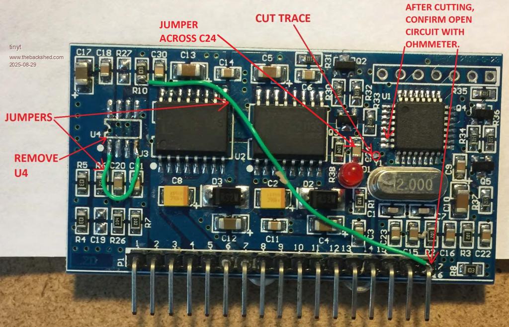

Just wondering TinyT, did you modify the 8010 boards on your inverters to prevent some of the problems that were built into them.
Years ago Oztules showed how to modify the boards, because they had a habit of over protecting and causing blowups like your board has had.
I have a few of those inverter boards running at my place. So far the only inverters that have died on me from Mosfet explosions were PowerJack inverters.
After a few blowups on them I rewound the transformers and used the aliexpress boards you have used and have not had a blowup since.

  Godoh said  Just wondering TinyT, did you modify the 8010 boards on your inverters to prevent some of the problems that were built into them.

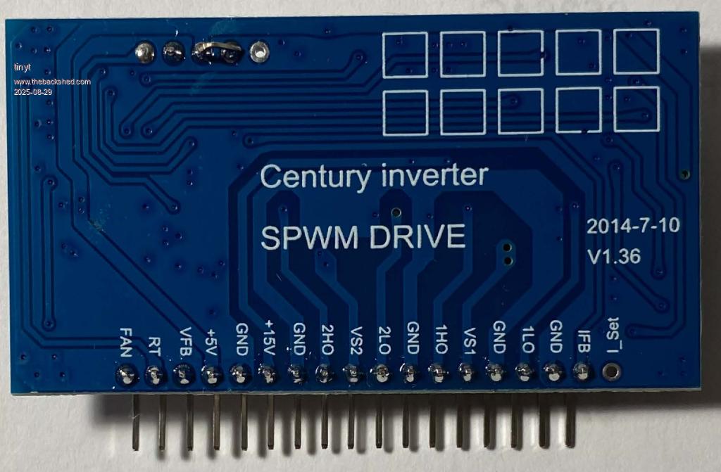

That inverter board came with an undocumented spwm board.
Claimed by the seller to be compatible with EGS002 (8010 chip). So I replaced it with EGS002(modified per oztules plus some more modifications).

Looking again at the EGS002 datasheet, I think you are right that the opto interlocking feature is not needed. It already has a dead time selection jumpers with a default setting of 300 nS (close to Wiseguy's driver's calculated RC time constant value of 360 nS).
So, I think what I only need is the addition of drive bias voltage. and avoid excessive overload. Am I right?
Edit: But then I think I still need the opto isolation without the RC delay to  make the negative bias voltage work.
Edited 2025-08-30 10:25 by tinyt

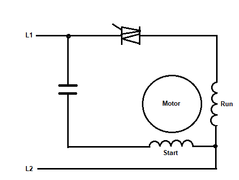

Posts: 3416
Posted: 03:30am 30 Aug 2025
Something like this. The existing controller relay contact could be in either L1 or L2.
tinyt
Joined: 12/11/2017
Posts: 564
Posted: 04:39pm 30 Aug 2025
  phil99 said  Something like this. The existing controller relay contact could be in either L1 or L2.
Thanks.
Yes, the deadtime setting is already there.  Also, EGS002 has cross-conduction prevention/interlocking output transistors.
I believe the opto interlocking came about due to custom EG8010 boards without cross-conduction prevention rather than the EGS002.  Still, having interlocking in the opto's won't hurt.
Yes, I believe so.
For sure, optos (with isolated DC-DC modules) are probably the easiest way add negative bias voltage.

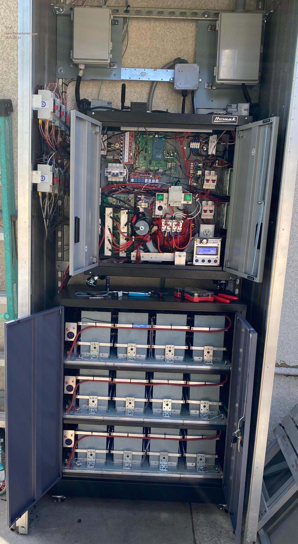

No change/difference. When I was assembling them I added two 10000 uF to the existing six 3300uF bulk capacitors. I also beefed-up with more solder and solid wires the high current carrying copper traces at the back of the power board. Maybe they helped.
The battery bank is 16S3P EVE LF105.

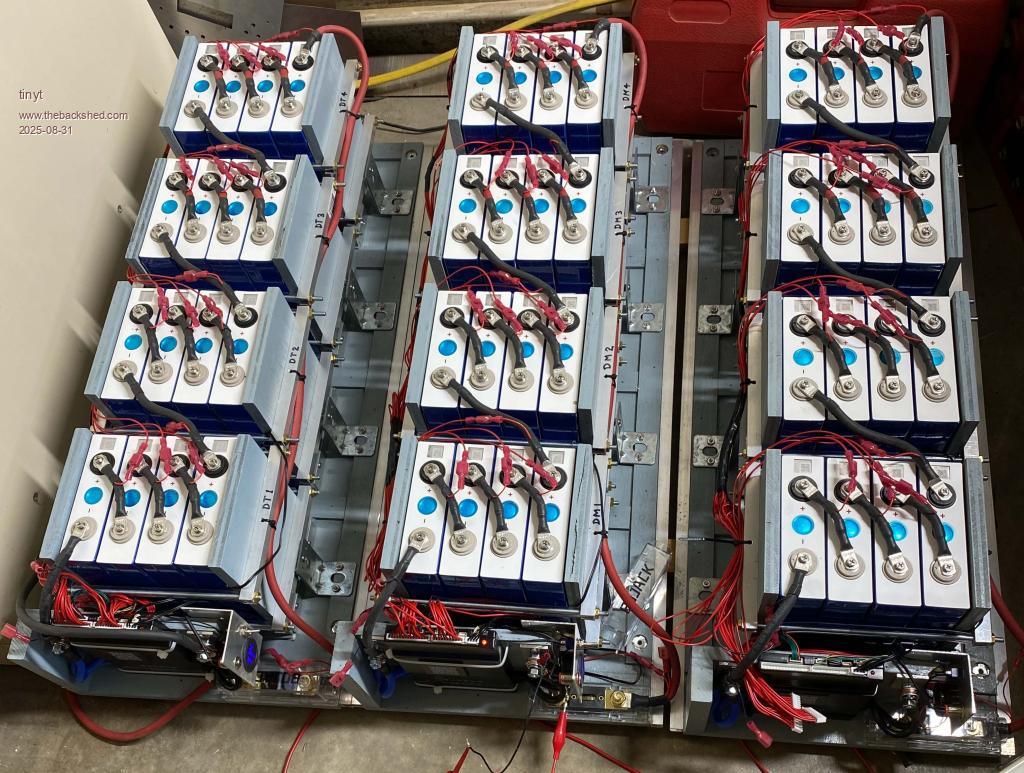

Revlac
Joined: 31/12/2016
Posts: 1309
Posted: 11:52pm 30 Aug 2025

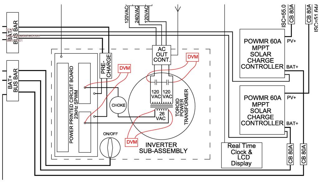

Interesting, I'm not sure if those inverter boards have low output voltage cutoff, and with what looks to a single toroid I suspect there was some AC voltage drop when starting the HVAC, if so the HVAC would receive much less current than the LRA rating and more like a sort start at that point, so yes it could start it and if lights where connected would have seen them dip/dim when starting large loads.
Only going by the information provided, probably a scope and some voltage logging would show exactly what is happening.
Nice looking build, would be interested to see how you go with a soft start.
Battery setup is looking good too.
Cheers Aaron

Joined: 12/11/2017
Posts: 564
Posted: 12:43am 31 Aug 2025
  Revlac said  Interesting, I'm not sure if those inverter boards have low output voltage cutoff, and with what looks to a single toroid I suspect there was some AC voltage drop when starting the HVAC, if so the HVAC would receive much less current than the LRA rating and more like a sort start at that point, so yes it could start it and if lights where connected would have seen them dip/dim when starting large loads.
The AWG8 wire length from the inverter cabinet port to the compresser is about 82 feet both ways which is about .052 ohms resistance. Including the added grid/inverter transfer relay contacts and inverter output contactor contacts, maybe series resistance is .07 ohms. So roughly voltage drop is 148 x .07 = 10 volts at the compressor. Including load regulation limitation of the inverter, maybe there is a limited soft start.
One of the four alarms of the EGS002 is undervoltage of the AC output and it is monitored in this inverter board. But detection and shutdown by the chip is 3 seconds after the event.
One of the strange behavior of the EGS002/EG8010 that we found out is under certain monitored AC output voltage condition, it will trigger overcurrent alarm despite it being disabled. It took us over a month to figure a solution and we are still not sure if we really fixed it. But that is another story.

The plan is to proto-type four identical small boards and connected them as shown.
Opto Driver_Bias.pdf
