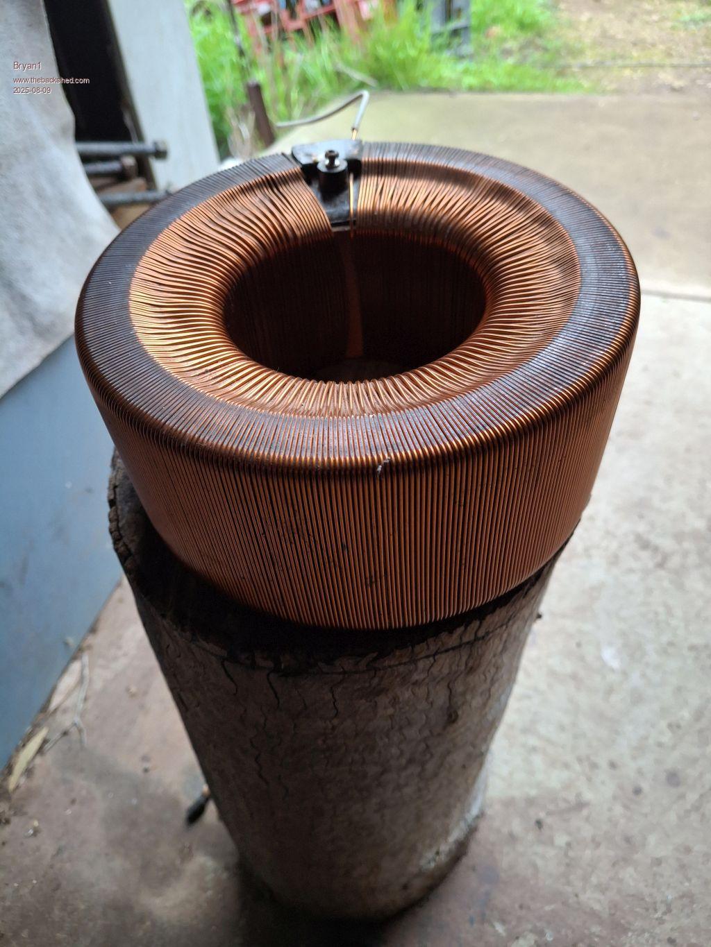

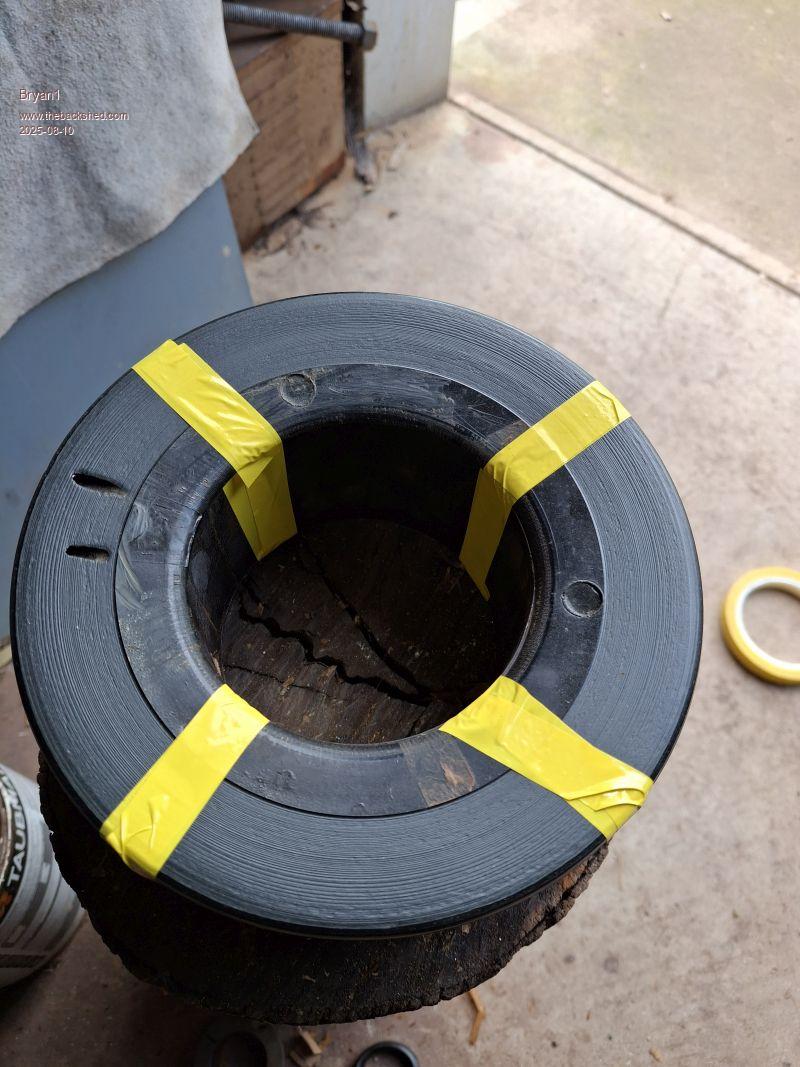

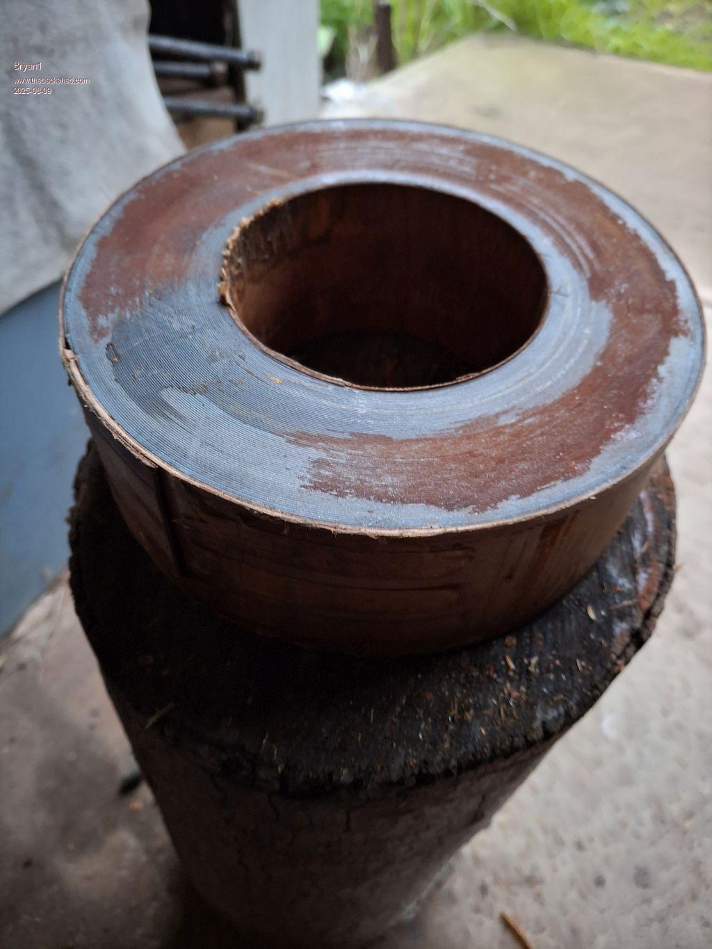

Ok bugger tomorrow was too long to wait   so here we are with a 172 diameter 90mm hole and 60mm high bare toroid
It didn't take long to strip the wire off and a quick tap with a hammer and chisel soon got the bakealite covers off to expose the toroid. Each edge will need to ground so a nice radius is there for the new wire.

I see you already did the unwind.
That core is a bit too small. It would only be around 1kva at that size.
The last core I would was 172mm OD 100mm Id and 140mm high. That worked out to be around 4.5kva.

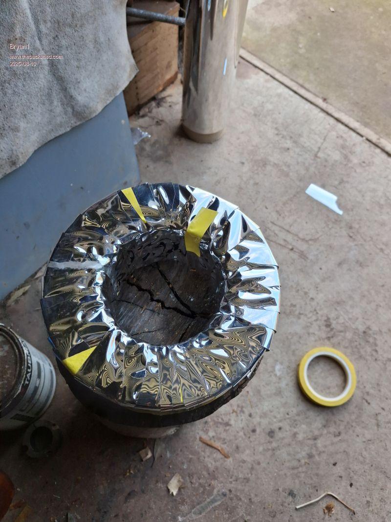

This morning machined the ridge off the top former
Then finally got my roll of Mylar out of the corner and wrapped up the toroid

Roger did give me a link to a couple of Aerosharps in Melbourne and I asked a friend over there to get them for me so next weekend he will pick them up   My friend did say he was going to come over and see me so he going to bring them over for me.
So my idea is to use this toroid on that inverter I have made which will free up a aerosharp toroid then for my Madboard it can have a 3 stacked toroid   just so I can get the best out of the inverter.
Cheers Bryan
