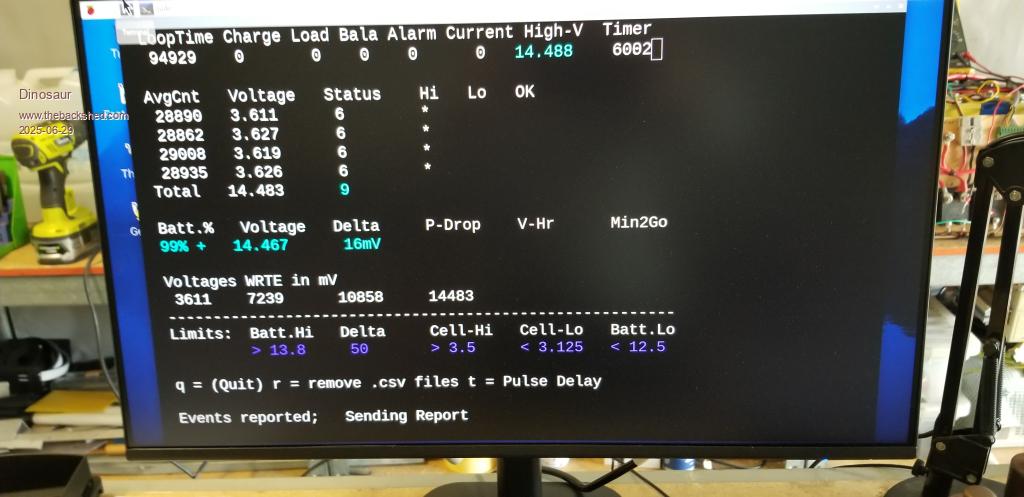

Joined: 12/08/2011
Posts: 360
Posted: 05:09am 29 Jun 2025
Hi All
Just a progress report.
Ended up buying DDR-15L-3.3 (spec's attached)
So, simply connecting my battary into 3p(2p) x 4s I ended up with 12v 300+ A/H of two different cell types.
I have 100AH cells and 200AH cells, so some are 2p whilst others are 3p x 100ah.
When charging the battery as a whole some cells are going to reach 3.5+ v before others.
That's when I stop the Battery charging and switch to Cell charging.
The DDR-15's are adjusted to 3.6v and will put out 4.5A or more depending on how far down the cell is.
If the cell is to far down the current limit is exceeded and the DDR-15 goes into "hiccup" mode. (their terminology)
The current tapers off when the cell gets closer to 3.6v.
The end result is that the DDR-15 will pump out 4.5A from about 3.25v resulting in the cell voltage climbing
about 3mV every 15 sec's.(If no load on battery)
The overall performance is a bit hard to read, as when I tested it,the cells at the 12v end were higher by about 200mV to start with.
This results in some settling to the next lot of cells.
Either way once they got to 3.61 approx, current dropped to zero and as you can see from the enclosed picture
the delta was 16mV. (ignore the 99%)
This is mainly due to NOT being unable to set the voltage accurately with the trim pot.
At the moment I am awaiting delivery of an accurate voltage reference and a current detector with logic output.
If during the day the solar voltage drops below being able to charge the whole battery (or gets less than say 100Watt),
the logic output will tell me and I will turn off Battery charging and revert to Cell charging.
I am using a 9v to 24v step up converter (10A) to power the DDR-15's.
Typically at the start it draws about 70Watt.(ignoring converter efficiency)
So if in cloudy conditions the solar panels can deliver 70 watt or less, I will get current to charge the cells
which I wouldn't if I tried to charge the whole battery.
I have turned my bench power supply down to 12v and lower whilst still getting 4.5A into a cell.
The current drawn by the power supply verified that.
Have not yet been game to test Battery Charging & Cell charging together.
The only issue is feedback voltage from cell to DDR-15, but it only draws 45micro amps per unit.
Tried blocking diodes (MBR-735 schottky) but current stopped flowing when voltage difference got less.
So, not sure what is going on there.
Then tried using p-channel mosfet TRF9540N as a blocking diode.
But it wouldn't even switch ON.
So, I guess 180 micro amps running 24/7 is not going to kill me.
DDR-15-spec.pdf
Edited 2025-06-29 15:10 by Dinosaur
