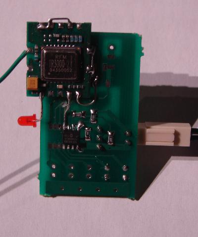

I have had more mixed results with the generic 433MHz receivers from Oatleys. I noticed that there appeared to be a cyclic nature associated with the reception quality. I had to make a new signal quality test unit. I used one of the tranciever units, as a reciever only. This turned out easier than expected. A single red LED in the RX + power supply line was enough to drop the 5V down to the suitable voltage from the plug pack. The units do fire up in receiver mode, with config pins held high.
The OatleyElectronics TXonly unit is programmed to send an additional nibble just prior to the main data string. This is a free running system. At a 1 second time interval, the program reads the variable, and then transmit it twice, as a decimal number. In this 2 step process, a different qualifier string for each transmission is sent, prior to the data.
The picaxe input pin had enough signal level to read the data stream from the tranciever operating at approx 3.3V.
I have overcome most of the reception problems by synchronizing the receiver to the data stream. I have done this by having the program look for the nibble packet, the 4bits, just prior to the main data stream. I use %0011. The receiver is waiting for a sustained high. As soon as the long high is received, the wait loop is exited and the input pin is monitored for serial data. If the qualifier is received, then serial data is read. The next qualifier is read, and if OK, the next data string is read. If the 2 strings match, then the data is treated as valid. The program continues processing the valid data, and then returns and waits for the sustained high again. If any errors are detected, the receiver returns to the wait cycle, without any data processing.
I will be looking at extending this system, to have a unit act as a repeater, and possibly bi-directionality.
The lack of chatter here, suggests few readers have experimented with this technology.
I hope to document the coding once the reliability is acceptable.
Gordon.
Here is a pic of the RX test unit.
These are quite acceptable to incorporate into projects, as most of the RF is integrated onto the small pcb. I would make a spot on a final PCB, for the small RF daughter chip.
become more energy aware

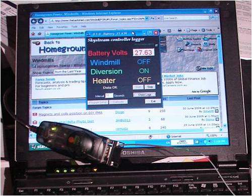

Units are working really well now. I now have a portable unit that indicates windmill operating status and battery charge status. All good for an RE system.
Gordon.
