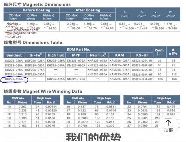

If I look up MS225 I find a 2inch core? Can you point me to one?

  davros said  Formerly North GTA now umm...east of Scugog?
I got the batteries that I used in my build from Port Perry, which isn't too far from you.
10 pack AS225 Cores

davros
Joined: 24/02/2025
Posts: 30

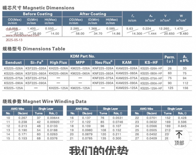

Posted: 01:27pm 13 May 2025
same?
oreo
Joined: 11/12/2020
Posts: 138
Posted: 02:03pm 13 May 2025
Keep in mind that this core size is typically best bang for the buck and can be found in other inverters so can be repurposed.  Larger sized cores can support thicker wire and perhaps be packaged better.  KeepIS is using ~10 stacked MS225 cores to build each 20uH inductor.  Check out his thread for pictures.
