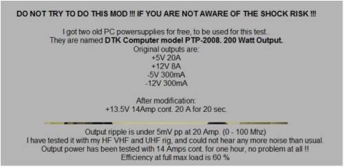

I had a SMPSU from an old PC. this was 200W with a tl494 PWM. I was able to find website power supply mods and this gives some instructions on mods to use as radio power supply, 13.6V output.
This used a model ptp-2008 cct design, of which I had the same.
I read a bit further and decided not to go further, when the important value 60% efficiency at max output came to light. Seems a lot of power goes to waste. Approx 100W wasted to give 200W output.
Here is the text.
There would be a better way to do things, so I would explore other options.
Gordon.

do you think that’s normal efficiency for an ATX, or due to the mods done on it? ie; unbalanced output. I modded a recent ATX for 48V output, but didn't check before & after efficiency.

I was told once on this forum that these units were efficient. There were claims of modded units better than 95%. This guy has made some measurements and come up with 60%. I cannot confirm these numbers. Mods will affect efficiency. Maybe VA was measured on the input and the power factor was not 1.
