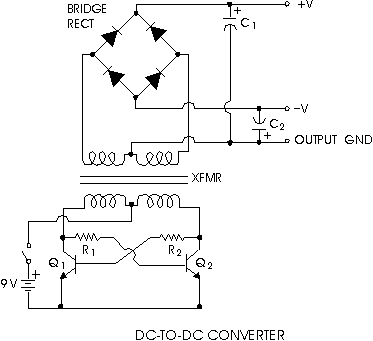

Arthur
A simple multivibrator circuit like this could use the little driver transformer from an at or atx power supply, and a much simpler output bridge..... don't get much simpler than that.
Picture from above link
.........oztules
