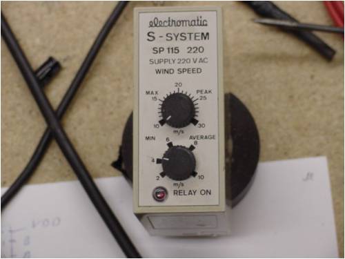

You asked to see the innards of one of the boxes I am fixing for the mills over here, and how I fixed it. I don't quite know what you want so here goes.
This 115 unit controls when to let the blades rotate. If there is not enough wind, it keeps the brakes on, When an average (settable from the front bottom control) wind has been established, it releases it's relay to let the brakes off.
Providing no other unit disagrees (phase drop, voltage wrong, vibration etc etc, the blades start to turn. It monitors this as an average all the time, if it slips below the preset (as an average taken over about 20 seconds (ish), it puts the brakes on and waits.
The top dial sets the upper limit you will allow the blades to run in. If it exceeds this it stops immediately.
This one won't come on.... so we open it up to find out whats inside.

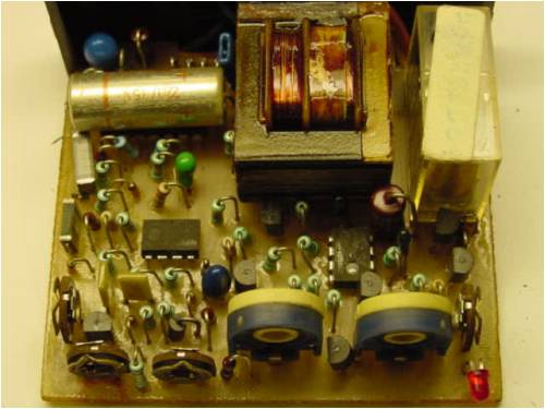

Note, the rotten #@#@(explicative deleted) ground the numbers off the two IC's... this makes it a bit harder.
After struggling with how it might work, I figured out the two IC's were simply lm358's. Tracing out the circuit around the devices led me to this conclusion, so with this in mind, I tested accordingly.
found the two outputs generated by the anemometer, the peak and the average signals. They were generated by one of the IC's. It went through some buffer stages (transistors) and wound up at the other IC.

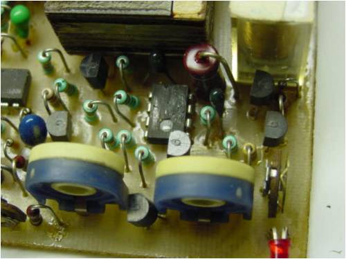

Knowing it was a lm358 by now, it was simple to find the preset voltages from the pots on the front panel, in the -in inputs of either op amp. One for average, one for peak. It simply beat one preset against the average signal, and one against the peak signal (against the peak preset). The average signal went to +in, the preset to the -in, but the out didn't change when I pushed the average signal up... dead 1/2 IC. So replaced that 358.
Now we had the signals OR ing to an 14541 programmable timer chip (under that big electro). It was getting the signal, but not resetting and counting down. This turned out to be a shot capacitor. Replaced it and she all works again.

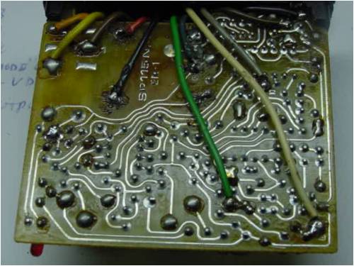

Here is the back of the board... at least you could see through it to trace the tracks to the component side:
Here is the preset area:

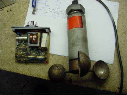

Now, what made this harder than it should have been, (apart from those devious devils grinding the numbers off the IC's), was that I had to turn this while I was searching for the signal paths...
I reckon it would have been comical to see... spin... measure measure... spin.. measure measure.
In the finish I used the heat gun on cold air to spin the blades, and interrupt the airflow with my elbow to simulate change.... such is life for the free serviceman I guess.

[quote]Here is the back of the board... at least you could see through it to trace the tracks to the component side: [/quote]
I find shining a strong light on the other side of the board helps when reverse-engineering such boards. Also much easier on the brain, instead of having to flip the board over 100s of times and visualizing it in mirror-image.

The Chinese inverters I have had to work on lately all use phenolic (or something like that) board. You cant see through with the brightest light. It is no go. I am useless at imagining in mirror image too, which makes it difficult.
