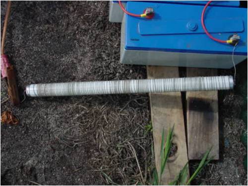

Yes and No. I haven't done the pipe and glass/plaster bit yet, but here are some piks of the test load. I put a fluro tube inside the wire just to hold it all together for testing. I guess if you cut the tit inside the end piece to relieve the internal gas so that there is no pressure when heating..... I don't know how the glass would respond long term.
Seems a bit flimsy to me, but ok to test with. Also depends how hot you design your load.
I will try to get the pipe and glass matting bit done soon.
So here is the wire resistor on the fluro tube.:

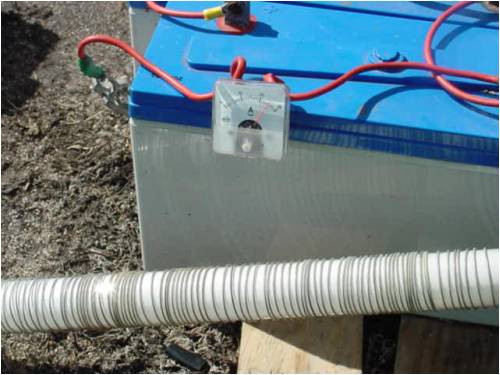

Here it is dumping @ 20A:

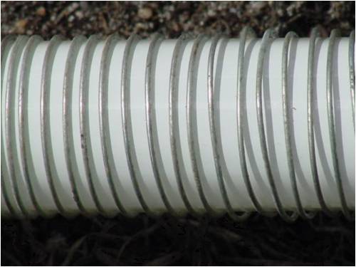

Close up of the twitching wire:

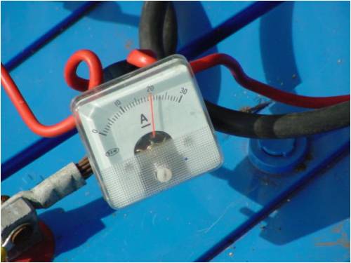

And (by changing the meter leads) here is the incoming power @57v.. 25A
So the chainsaw blades are still working. (I am still waiting for Niall to get his in the air.)
I'll need two of these at most now I have the furling point lowered.
